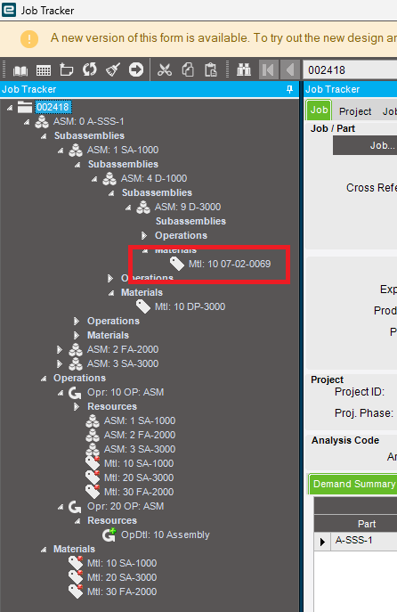

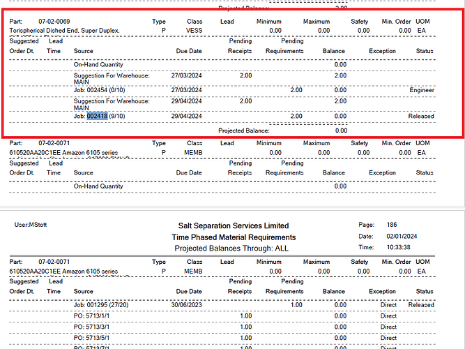

I have a problem and I’m not sure if its how I have set the job up, can I have some advice.
I have a parent Job 002418 with a multi level bom for a Part
when I run MRP and look at the time phased requirements I am seeing double supply.

If the prod quantity on the job is 2 and the part is not fixed quantity then this looks fine.
Hi Greg,
Should I still see the pending requirements on the parent 002418 as well as the child 002454
