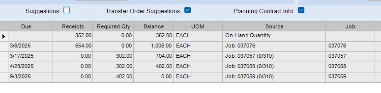

We have created a job 037076 for the part, added the same part as a material line and added a subcontract operation.

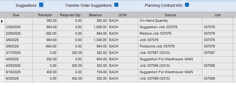

What we are encountering is that we are getting PO suggestions for the part when there shouldn’t be any as following them will give us excess parts that we have no demand for. We are also getting suggestions for moving/modifying the job quantity.
Is there anyway that we can suppress New PO suggestions for this scenario so our purchasing group does not buy more than needed?
