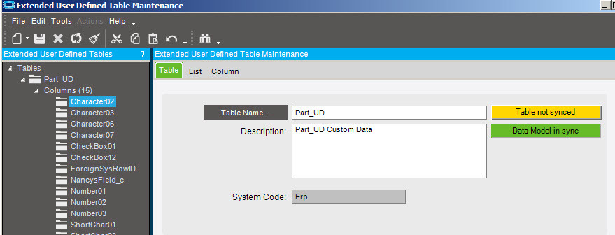

In Extended User Defined Table Maintenance, I’ve added some new UD fields. However, the Actions drop down is disabled and I cannot Sync it to db, despite the fact that the table is clearly marked with the status “Table not synced”.
Does anyone know why I might not be able to pick to sync it?

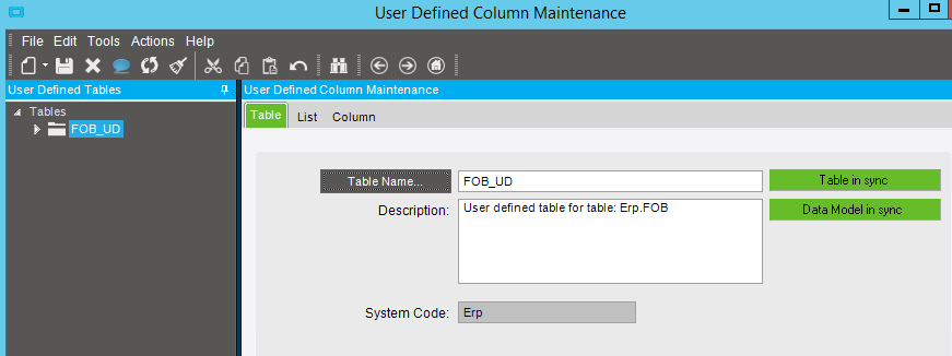

Hi does anyone know what this happen as from server access Epicor i noticed the data table synced nicely after I regen and app pool recycle, but from client station I’m hitting following error:
I did clear client cache from the client end but still same error.
Hi Jose,
Thanks for your response, I has try number of time with the same steps and I still hit the same issue, and this is my first time hit the funny things which I has regen a lot round from the pass.
for the server I’m using RDP(Remote Desktop) for access the server, for the client site I has install the Epicor client at local PC and just run the Epicor locally with the sysconfig poiting back to the server path.
Hi jose,
i finally found the root cause, the Epicor sysconfig was corrupted, i has try to copy the server sysconfig file and replace the client site config folder then its working, the table show synced successfully.
