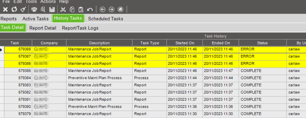

We have an issue which is happening regular but intermittantly.
When printing, sometimes the print fails and error in system agent states the handle in invalid- see error below:
Ive just setup an Autoprint on record creation to print maintenance jobs once scheduled, as you can see from the screen capture, it sends the prints, sometimes they print sometimes they error
Our support company suggested it may be a print driver related issue, we have updated the print drivers to HP Universal Printing PCL 6 (v7.1.0) - but still having this issue - please help!!!

Wondering if there was ever a resolution to this issue. We are just now experiencing an issue with printing labels on our zebra printers. We get the same error message, the tags don’t print but it says they printed in the queue, it is intermittent and we are on Kinetic 2024.1. So far Epicor support hasn’t an answer.
So your using SSRS to print the labels or Bartender?
This is using Crystal version of the labels. We also tried the std SSRS labels but they act the same way. The application says it prints but the printer does nothing. It’s like there is a drop in the communication to the printer???
