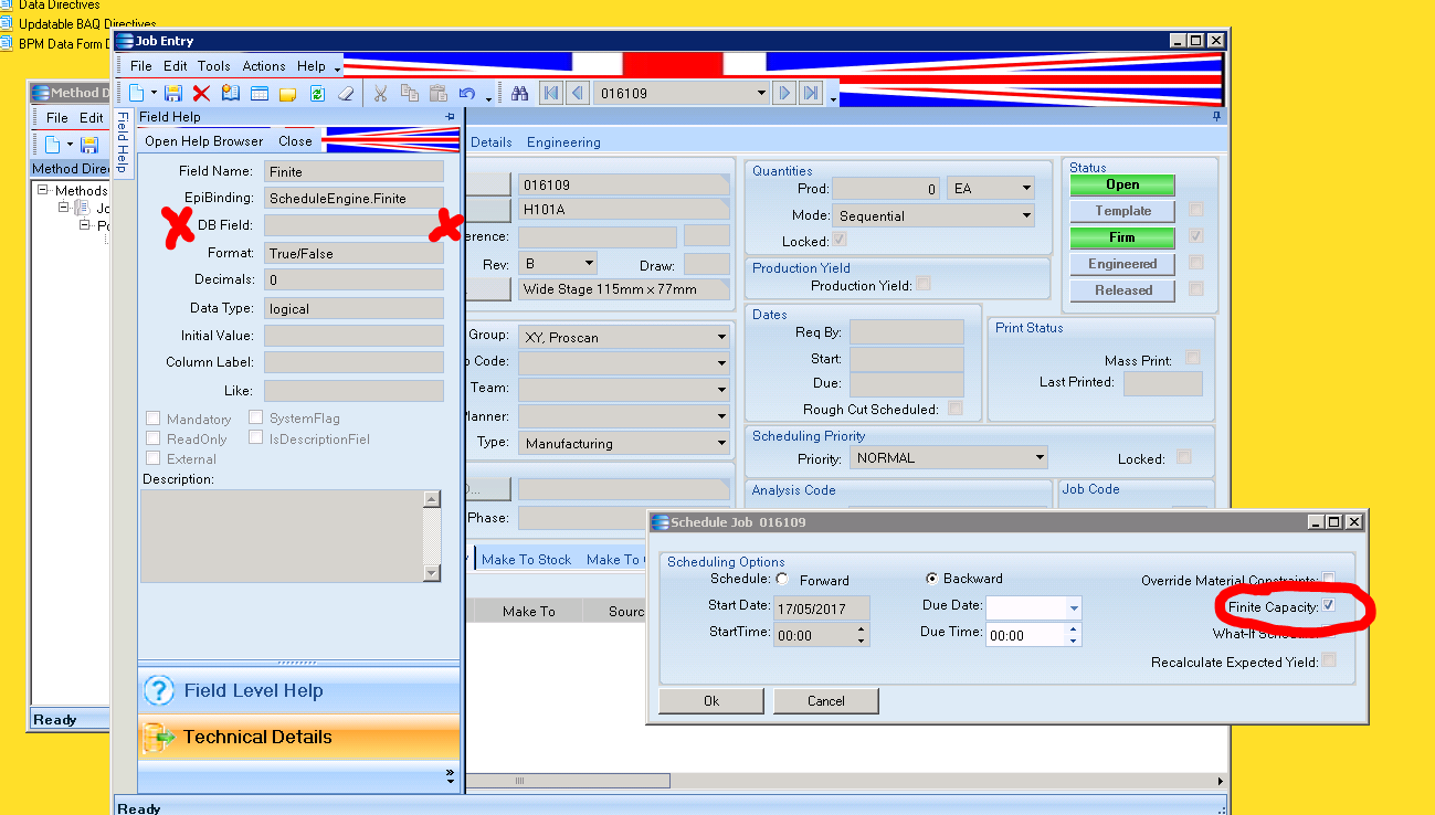

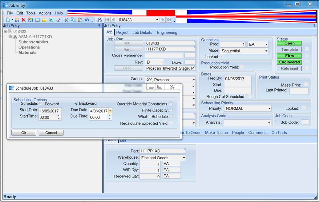

I’m trying to write a bpm to default the field “Finite Capacity” when you click Actions/Schedule/Job Scheduling from Job entry.
Does anyone know the correct Method Code and Business Object?
Thanks in advance.

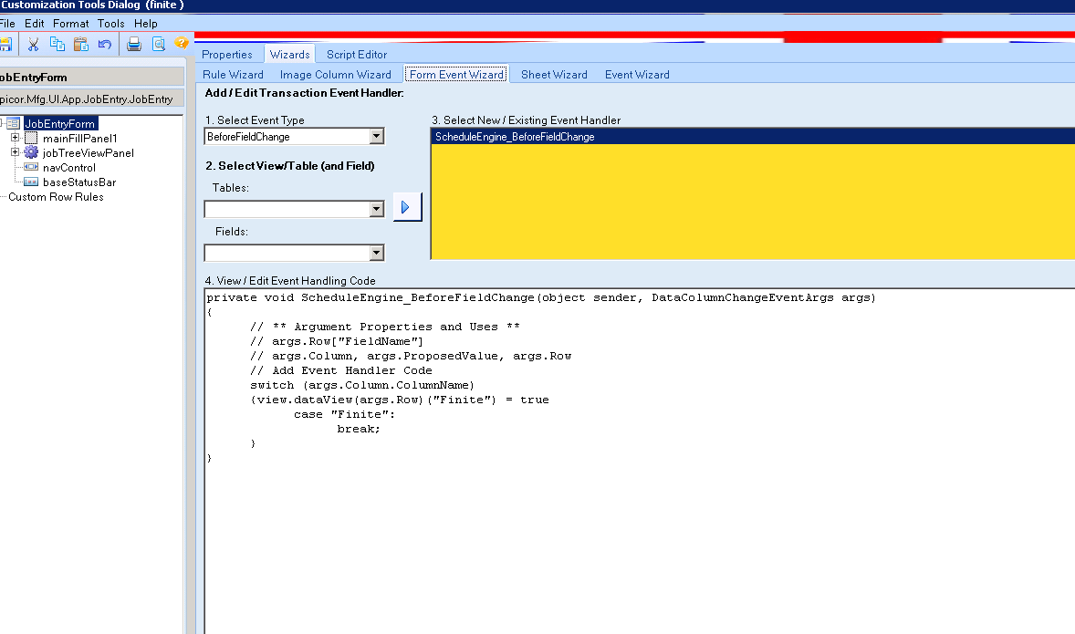

So, it looks like the answer sits behind customisations and then Form Event Wizard…ive done the following:
and then go back to the script editor, but what do i write in the script to say make the scheduleengine.finite field default to TRUE?:

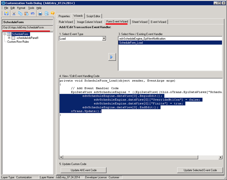

Here is an example of setting Finite when the form loads.

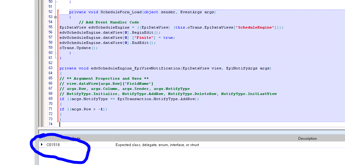

as the below didn’t work, so i guess i’m missing a step.
private void ScheduleForm_Load(object sender, EventArgs args)
// Add Event Handler Code
EpiDataView edvScheduleEngine = ((EpiDataView) (this.oTrans.EpiDataViews[“ScheduleEngine”]));
edvScheduleEngine.dataView[0].BeginEdit();
edvScheduleEngine.dataView[0] [“Finite”] = true;
edvScheduleEngine.dataView[0].EndEdit();
oTrans.Update();
private void edvScheduleEngine_EpiViewNotification(EpiDataView view, EpiNotifyArgs args)
// view.dataView[args.Row][“FieldName”]
// args.Row, args.Column, args.Sender, args.NotifyType
// NotifyType.Initialize, NotifyType.AddRow, NotifyType.DeleteRow, NotifyType.InitLastView
if ((args.NotifyType == EpiTransaction.NotifyType.AddRow))
if ((args.Row > -1))
the above entered onto Form Event Wizard using event type as “LOAD”

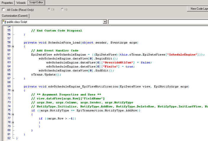

I use the Wizards to make the shell (and supporting code) , then just edit the body of the function

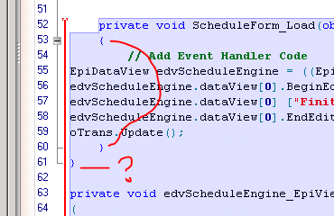

Mark - I don’t see the point of Bruce’s 2nd function …_EpiViewNotification(…)
Try removing that. And it definitely should not be inside the Load function
EDIT: The text you posted doesn’t even have properly matched parenthesis for the EpiViewNotification function

Edit: I also now see the the first function is inside of another.
I think Bruce needs to confirm that.

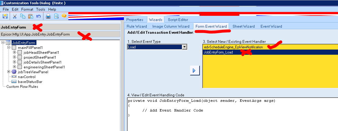

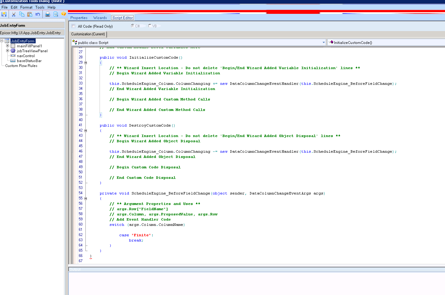

maybe part of the problem is i am applying the C# syntax to JobEntryForm,…i guess it should be to ScheduleEngineForm but i don’t know how to change that
then the next step is making sure the syntax is correct.
ScheduleEngineForm
Definitely…

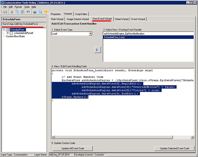

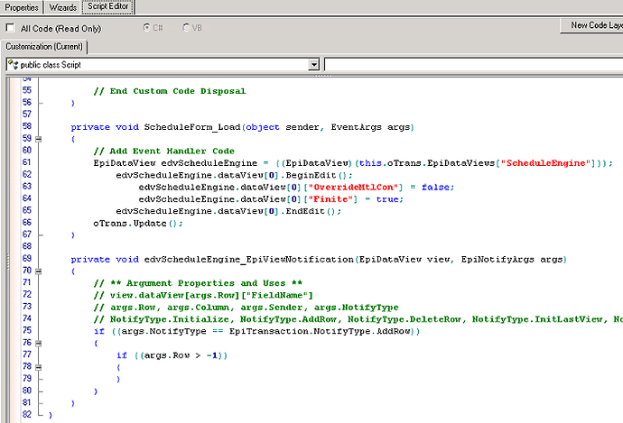

And yes, braces are not complete, I added partial screen shot.
So copying characters verbatim will result in some errors…
Maybe try again from scratch

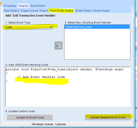

Use the “Form Event” Wizards
  • add EpidataViewNotification
  • add Form Load
Then insert this in the form load function should work?

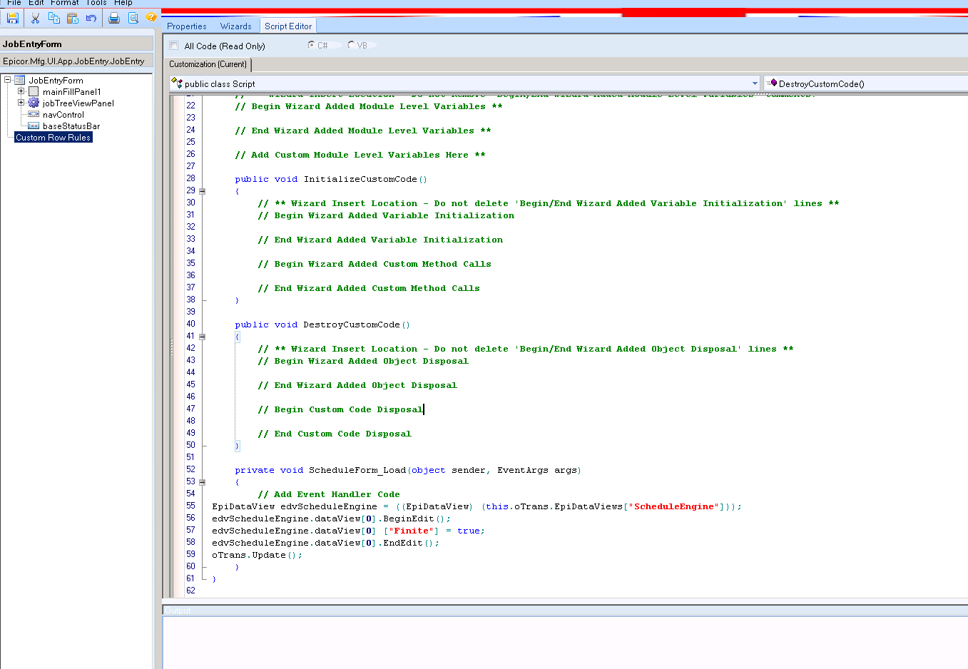

edvScheduleEngine.dataView[0][“Finite”] = true;
oTrans.Update();
Maybe this screen shot is a little better

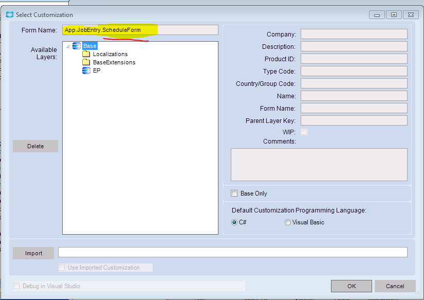

Most forms allow for customization. Just make sure the Developer mode is enabled before doing whatever launches the form you want to customize.
If the form is not customizable (like BAQ) you’ll see:

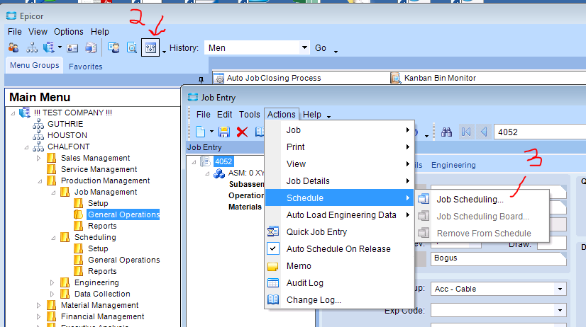

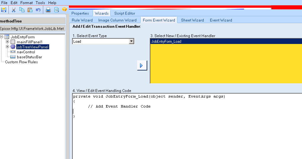

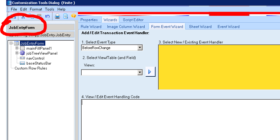

As per screenshot, i’m falling over on the first hurdle…i can get the epviewnotification easy…but how did you manage to get the schedule form part?
  1. With Developer Mode OFF, open Job entry, and load any job (or create a new one)
  2. Enable Developer Mode on the main window
  3. Back in the Job Entry form, select Actions -> Schedule - > Job Scheduling
The customization select for JobEntry.ScheduleForm will appear.
Load the Base, then in the Schedule form Right click to access Customization
Big thank you to Bruce and Calvin,
thank you both for your patience!..it works
