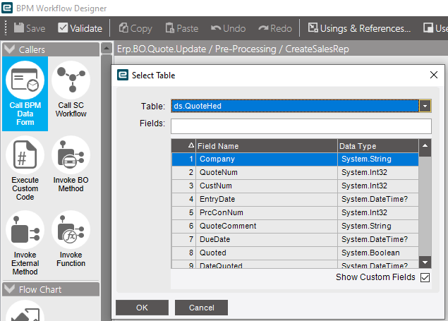

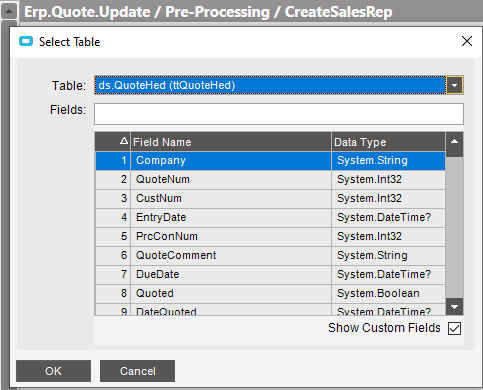

We just switched to Kinetic and noticed that the tables quote has somehow changed.
1.) Kinetic - there is no tt anymore
2.) 10.2.600- there used to be a tt
This has created an issue with our previous BPM where it is calling for ttQuoteHed instead of ds,QuoteHed. BPM is now behaving incorrectly. Has anyone encounter the same issue and how can it be fix? Please help.

Please see below code.
This used to only mark the person creating the quote as Primary Sales Person.
But now, it marked multiple Sales Person as Primary.
