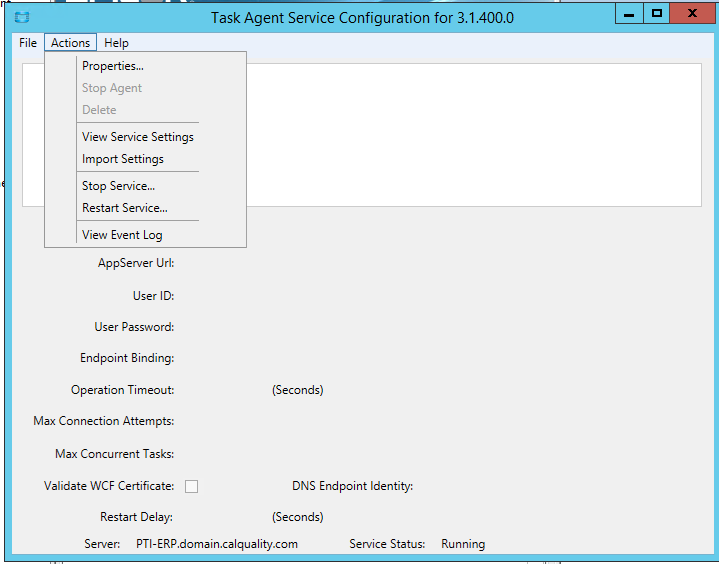

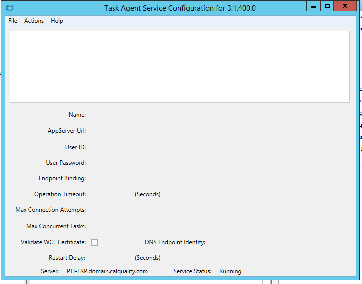

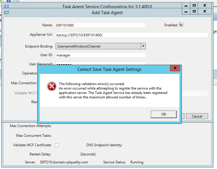

After stopping and restarting the task agent (we had some reports stuck), our task agent just disappeared! (See screenshot) If we check the View events log, “No agent settings have been configured”. If I try to recreate it through Add Task Agent, it says that a “Task Service Agent has already been registered with this server the maximum allowed number of times”
Has anyone had a problem like this and was able to solve it?

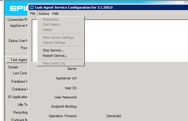

can u plz post the screenshot of ur task agent confi.n Action menu ? like this…

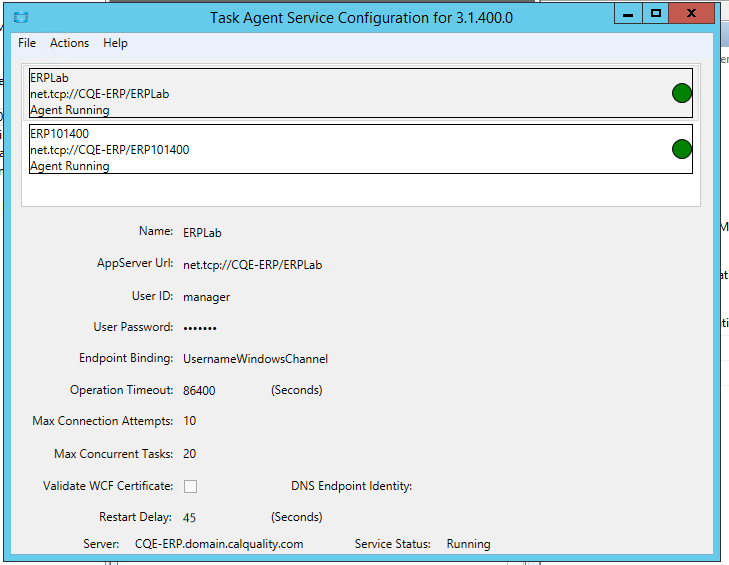

Sure The Task Agent is gone and stop service / restart service don’t bring it back as it shows in another server (third screen shot)
If I try to recreate it, I get an error ̣second screen shot)
Dear Daniel
Same issue i have got yesterday please run this you will be able to add new
task agent
delete from ice.extserviceregistration where serviceid=‘TaskAgentService’
( to remove complete taskagent)

Dear Shaik
GREAT! You solved my problem. After unregistering the Agent with your query, I was able to add the Task Agent again and now it works like charm!
Thanks again!
