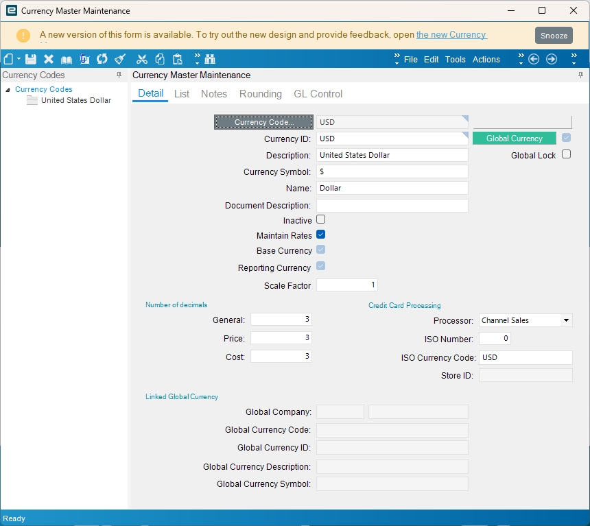

You can control this through Currency Master.
This will be in: Financial Managment / Accounts Payable / Setup / Currency Master
Epicor has more info on Currency Master at the help zendesk here:
https://erphelp113200.zendesk.com/hc/en-us/articles/31759230969869-Understanding-Currency-Master
Do take note that you cannot change the general decimal field if the currency has already been used by a document.
I think the number of decimals is tied to the company install. For example in the Demo System the EPIC06 company has its base currency setting set to 2 decimals…
However. If you can change the values in currency master maintenance to override those settings but it appears to be a one way trip, go more decimals and you can’t make is smaller later. When I tested this I got a warning about it…As soon as you start transacting you with that number of set decimals it won’t allow you to make it smaller.
