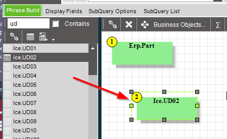

For this case, If it was me, I would populate a UD table with information you need. That’s what they are there for. Then you can make the query that grabs the data from the UD table. To get it loaded in, you can either use DMT (if you have the license), or customize the UDEntry screen for the table that you are using, You can copy paste in to the grid view to bring in the data. A third option is to create a UDdashboard which can basically act the same way. If you really want to, you could also do a service connect workflow. There are lots of ways to skin that cat.
