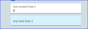

I usually add an event that fires after form_onload … or when the textbox in question is created … in that event is just a row-update setting the value to ''
That way, it has a value, but the value is nothing…
Similarly, I use 0 for a numeric box
I was really hoping to not have to do that, but it seems like the only option.

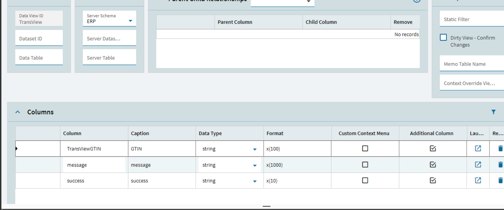

Add the column in transview dataview first. While you don’t have to, this should appease the validation gods.
The validation gods are not appeased. They are still angry and hiding the field.

You don’t have to do a space though, right? You can just do “”. Double quotes.

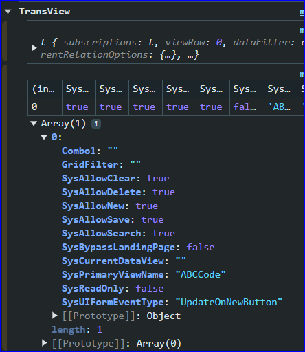

TransView before:
No TransView.Test showing.

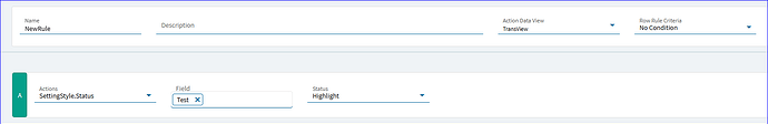

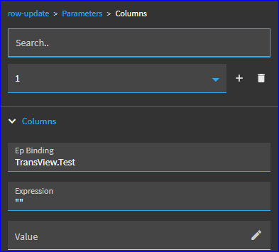

Row Update (after form_onload):

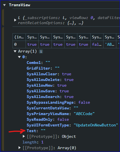

TransView after:
Doesn’t need to have a space… just a row update to kick it in the ass and get it into the DataView.

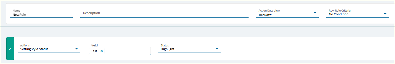

Row Rule takes effect. no other prompting needed.
Yeah, I put in two single quotes with nothing between … it sort of looks like there’s a space there, because code-text is monospaced (every character has the same width)

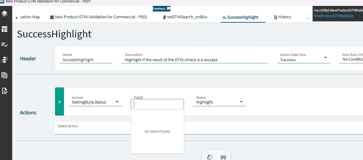

I found that if I add fields to TransView I have to save the application then exit application studio completely then go back in to see it. After that it is fine and I can use it in events and functions.

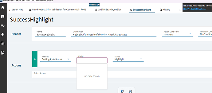

Now I can bind to it a text box even set it with an event using results from a function but the row rules can not see any of the TransView fields so I cannot put a data rule on it.
  • I can initialize it with an event
  • I can update it with an event using a function to change the value - I thought this would be the hard part.
  • I can verify its changed as I can see it in the text box
  • But the data rule wizard does not show any of the TransView fields?
  • If I manually type the field name in it disappears
And of course I can see the fields in the data view itself.
What am I missing?
