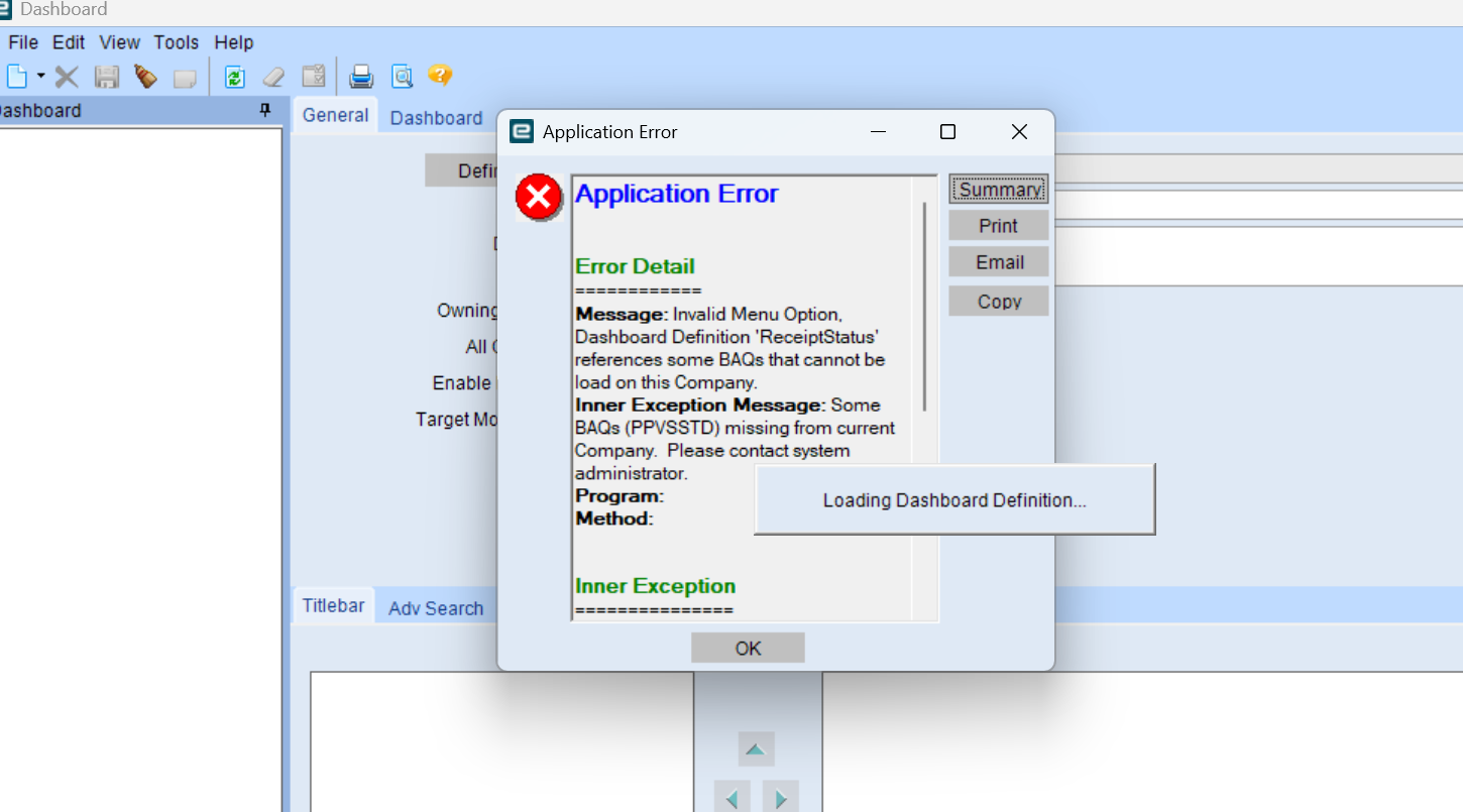

I had a dashboard with several BAQs. One of the BAQ tabs became unnecessary, so I ended up deleting that BAQ first. I should have deleted that tab from the dashboard first, but I completely forgot. So, when I tried to open the dashboard right now, the following pop-up appeared and it wouldn’t open. I tried to recover the BAQ, but it has already been deleted and cannot be recovered.

Can you create a BAQ with that name just to open the dashboard and delete the tab?

Unfortunately, I don’t remember that BAQ name. If that is the only way, I guess I should try it with names that have several possibilities.
PPVSSTD is the name, i think, from your msg
:sweat_smile: I couldn’t see the correct answer right in front of me. Thanks.
