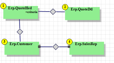

here is the BAQ
I have added a parameter for QuoteNum and in the QuoteHed table.

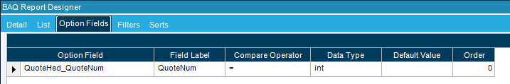

Hi Taheem,
Can you show what the ‘Option Fields’ looks like for the BAQ Report in BAQ Report Designer please?
Thanks,
Nathan
Sure!
Great, can you try removing the parameter from the BAQ as well as the criteria that relies on it? You’ll need to leave the option field as it is.
Thanks,
Nathan
omds thank you, My report style still had C:/ on it :man_facepalming:t4:. It works without the parameter and just tried with the parameter but it gave that error.
