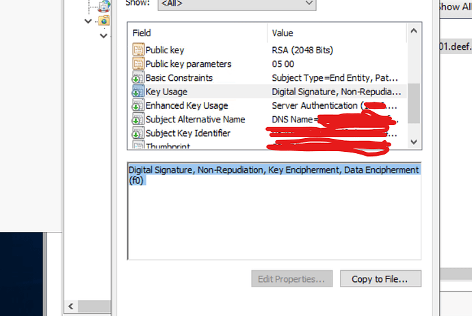

Looks like a certificate problem. Check the certificate you have deployed with. I assume you used a self signed certificate? You might not have the Key Usage values correct. At a minimum, it needs these:

I checked the certificate and the key usage values are correct.
