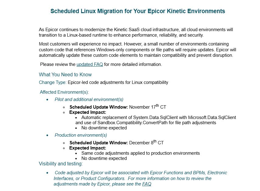

I’ve had some pathing issues lately that have been resolved by verifying the case sensitivity on the server paths. Assuming it’s this whole Linux migration preparation, but could be wrong.
What does Linux have to do with this? Is that specifically for this invoice process?
Probably referring to the upcoming Linux migration for cloud.
