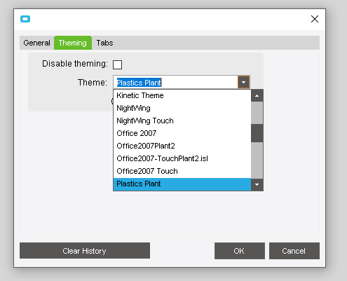

I created copies of 4 of the existing themes and changed the border on our Plant2 so that users will know which plant menu they are in. MfgSys or Plant2.
I then instructed our users to go into Preferences and select which theme they prefer and I set one of the themes to our default.
I have one user who would rather have just the Epicor default so she goes into Preferences > theming tab > selects “Inspired” hits ok. Exits Epicor and goes back in but it never saves, her theme preference returns to blank with no selection.

I checked in her Epicor client folder and the themes I created are not in there but there are others which she could choose, but none of them stick. When she reopens her session the theme selected is gone and the text box is blank.

I might have steered you wrong on the Themes. I don’t think the Client program has to have the ISL file local on their machine. They just get copied there during the Client install. So if one was added to the server later, it wouldn’t be on the client, but would be available to the client. I think the details of a theme are stored in the DB. The ISL files are just an “exported” copy that you could then modify and re-import (via Theme Maintenance).
