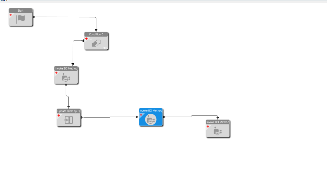

hmm not sure actually, I’m still getting the error message now:
- Check if BPM was enabled from preprocessing
- GetByID
- Update msc charges row
- Update
- GetById
Still gives the row modified by another user @Jonathan
Not sure what the Update Table by Query actually does, try replacing that block with something simpler like modifying a single field like a description or date, and see if that triggers the error.
No error, but the change doesn’t commit or come through at all.
Maybe you could find a bpm somewhere in the forum that you can import or recreate and see if it works.
I have the exact same thing made for quotes and it works great. I have no idea why the same thing doesn’t work for Orders
