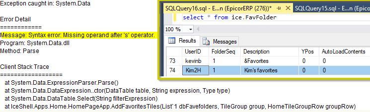

This is a bit concerning
Yep. Using non web-safe characters can cause issues. Can you update that to:
Kim's
And just curious…
Wonder if anyone knows why some processes recognize certain characters in description field as an “opertator” instead of text?
Or how programmers might deal with this problem.
Just curious … Should the Description for kevinb be:
&Favorites
Looking closer at the trace, it appears to be an exception to ExpressionParser.Parse method in the System.Data library. I suspected web parsing since an Active Home page involved but this is happening earlier during some lexicographical parsing - so the apostrophe would have to be escaped.
