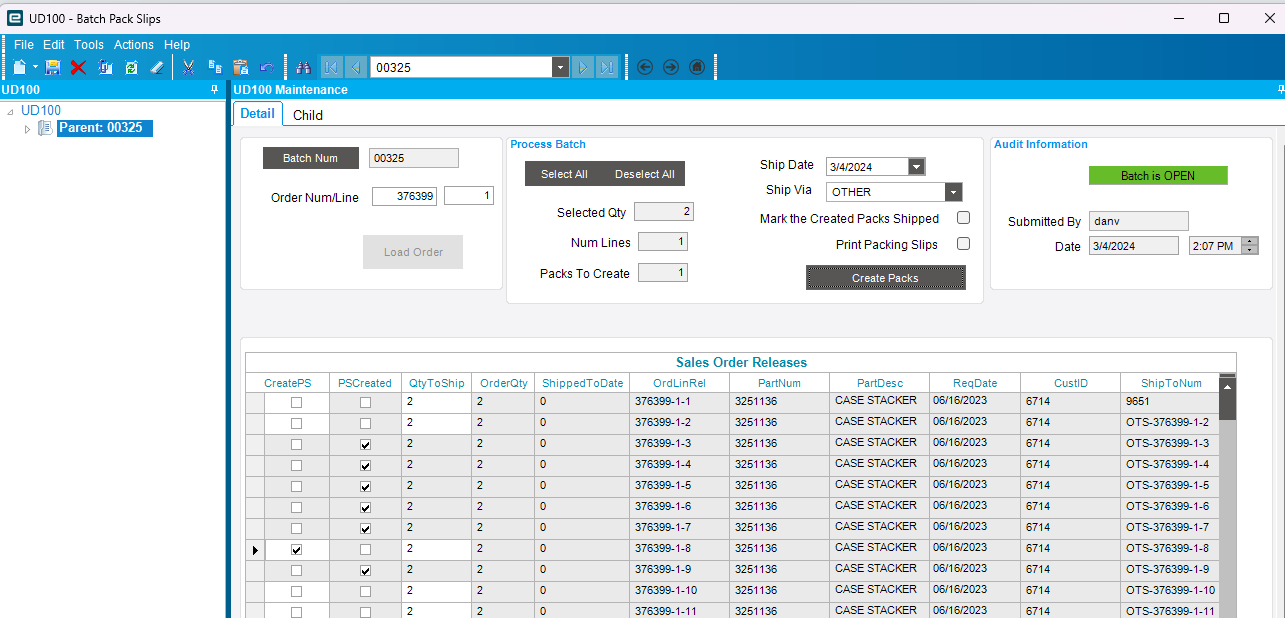

We have a customization that is used to create packing slips for orders that have many releases all shipping the same product to different locations. This visual might help -
The “batch” information is stored in ice.UD100. The Release information is pulled into ice.UD100A.
When the Create Packs button is pushed, it will cause the UD100 pre-processing BPM to fire. The BPM was responsible for writing the pack and shipment line information for an XML file for each pack. Service Connect would then pick up each XML file and create a Pack from the data in the XML file.

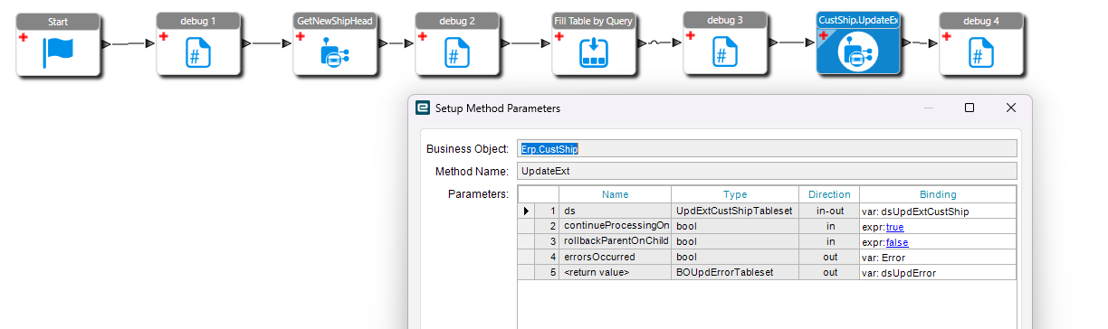

Here is my function flow for creating the ShipHead record -
If I strip everything out of the BPM and just use it to call the function with hard coded parameters, the function works as intended.
The complication comes when it is called in from the BPM that is looping through a couple datasets to get the values to use for function parameters

@josecgomez When the “Requires Transaction” checkbox is not set, the function will error out when the UpdateExt method is called.
When the “Requires Transaction” checkbox is set, then the function will error out sooner when the GetNewShipHead method is called.
