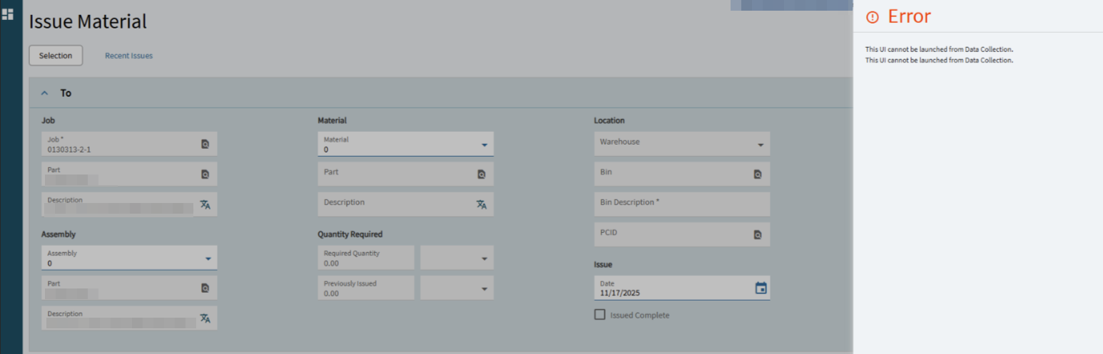

This UI cannot be launched from Data Collection ERROR
Has anyone seen this error and if so any idea why it is happening?
This is happening so infrequently, the only thing i can see from EAC is the user has been in MES and then has moved into Kinetic but the license still being used is a DC one. Like i said, it isnt happening a lot but when it is we are having to delete the session from EAC and then clear the user cache in the browser as it will not allow the user to login back to Kinetic. When they try and login, they click sign in and the screen just refreshes, clearing the cache resolves this.
It depends on how the user initially logged in to the system and was assigned a license – consuming a ‘Kinetic’ (or ‘DefaultUser’ when reviewed in Session Management) license or consuming a ‘DataCollection’ license. In this case, the user initially logged in to ‘Data Collection’ and was assigned a ‘DataCollection’ license, which has limited access compared to a Kinetic license.
They need to log out and log back in to Kinetic
I have an end user who goes into MES , issue material , then after they enter the job and the information loads they right click on the job to go to job entry and does not work. This use to work as of Friday 11-14-25 , thoughts?
Epic care is notating to me that they need to be using a full license but the MES user has been able to use this since November of 2024
Thoughts on how to fix this?
The user needs to log out of the MES License and then log into the Full client.
Alternatively, have the user log into the full client to get a license before opening MES if they need to jump back-and-forth.
Understood, should I have the user go straight to the URL for our MES or have them open Office MES menu item from full licensed Epicor?
They can use the MES URL after logging into the full client.
thank you! :handshake:
You’re welcome. Just watch license usage so you don’t bump into running out.
