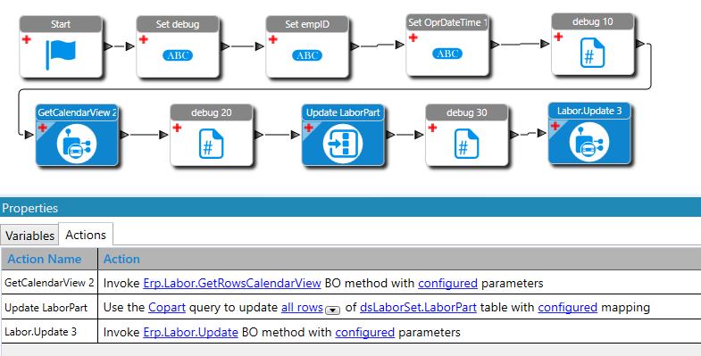

The base function begins by adding a new Time Detail record for the Job/Operation and saving it. Then if coparts are involved, I have a for-each loop that calls a function to up the copart Production quantity and save the change for each copart.

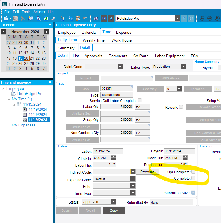

This function works perfectly when the Time Detail record created is the first record created for the LaborHead. The labor quantity is set correctly on the LaborDtl record and the part completed is automatically received into inventory on the Job.
The head scratcher is that if the function is run to create another Time Detail (LaborDtl) record for the same header, the copart quantities update, but the labor quantity is not set on the LaborDtl record.

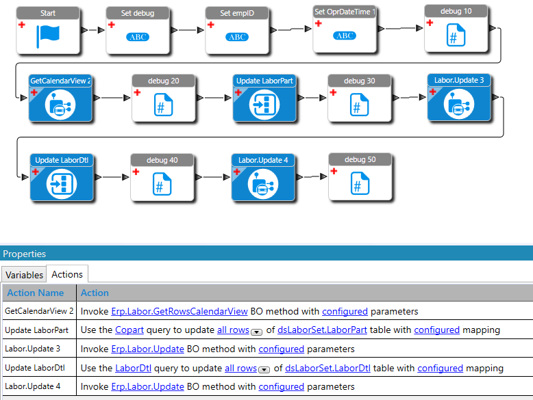

I’ve been able to compensate for this by adding another step sequence to the function to also update the labor quantity on the LaborDtl record.
In testing, this has allowed the coparts to be received to inventory on the job manually and the job can be closed. However when the Time Detail entry is for a quantity that completes the operation and completes the job, those fields aren’t toggled to true.
