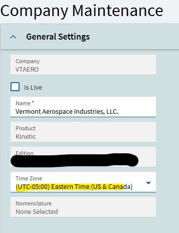

Today our engineers noticed that the memos they create are going in with a timestamp an hour later than they are actually being submitted. We are EST, our cloud server says Central. If anything I would expect the time to be an hour behind. Could this be a daylight savings thing? Where can I look to change this so it shows the correct time for memos?

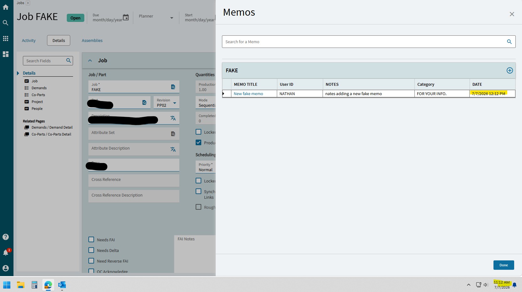

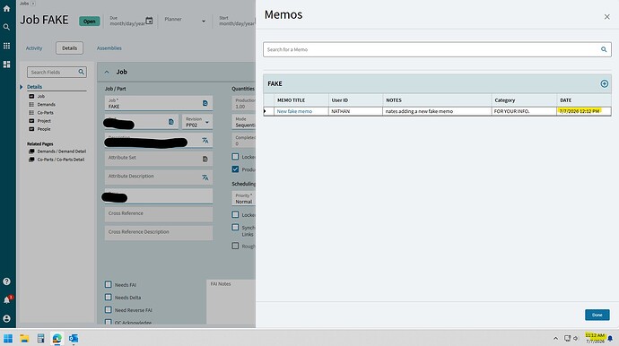

Here you can see an example where I reproduced the issue on a fake job.

The Ice.Memo table shows the date/time as 7/1/26 1:19pm. The memo shows the date/time as 10:19am, and the memo was entered at 9:19am. :thinking:
My setup matches yours except the server time zone (eastern), and my conversions are working properly (-4 hour offset). Makes me think it might be using central when entering the timestamp for some reason.

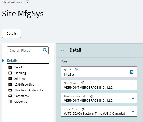

Is your time zone also set on the site?
Yes:
