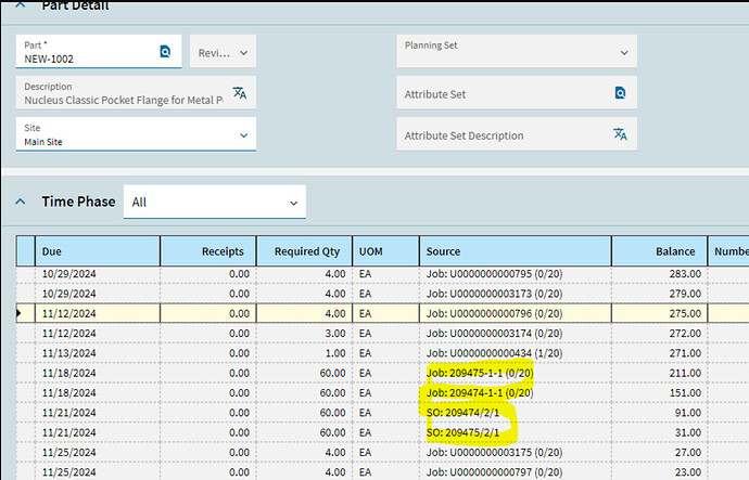

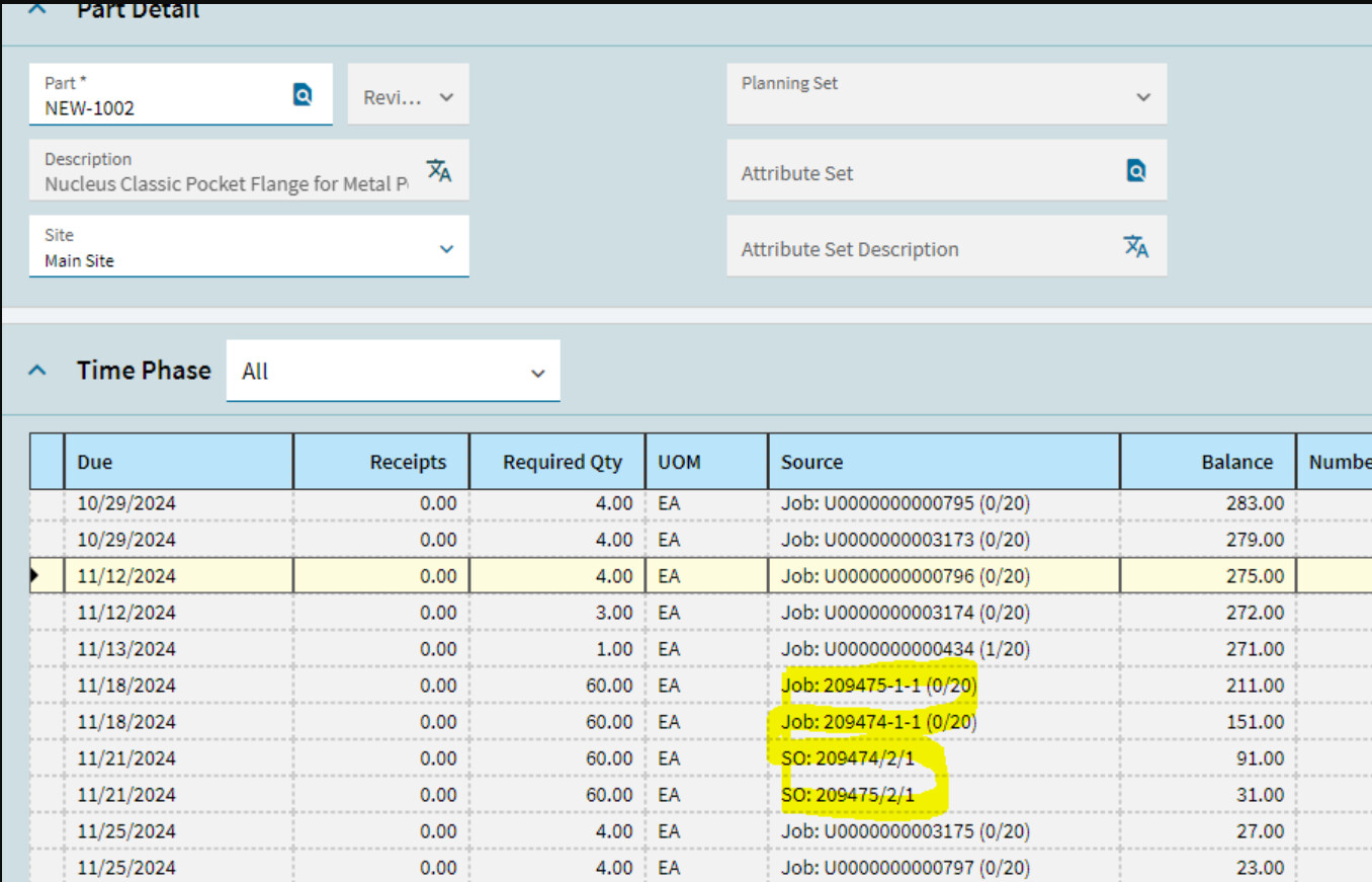

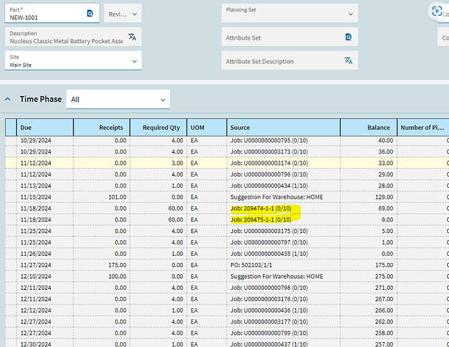

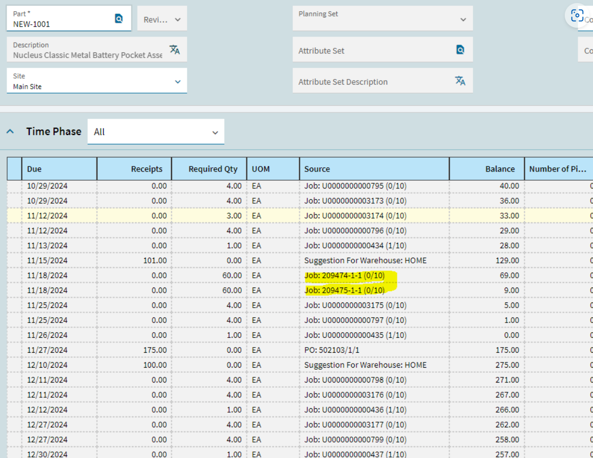

Assembly B507 contains two parts: New-1001 and New-1002. While New-1001 appears to be correct, New-1002 is causing demand to double.
It is driving demand for both the sales order and the job created. Can you explain why this is happening?
Part : NEW-1001
Part : NEW-1002
It appears that the NEW-1002 is a material for your Job and that it also appears on the two SOs as Line 2.
Correct.
The Jobs shown for the NEW-1002 are referencing to the Jobs for Line 1, SO#-1-1 as Material 20. The NEW-1001 is referenced on the Jobs for Line 1 SO#-1-1 as Material 10.
