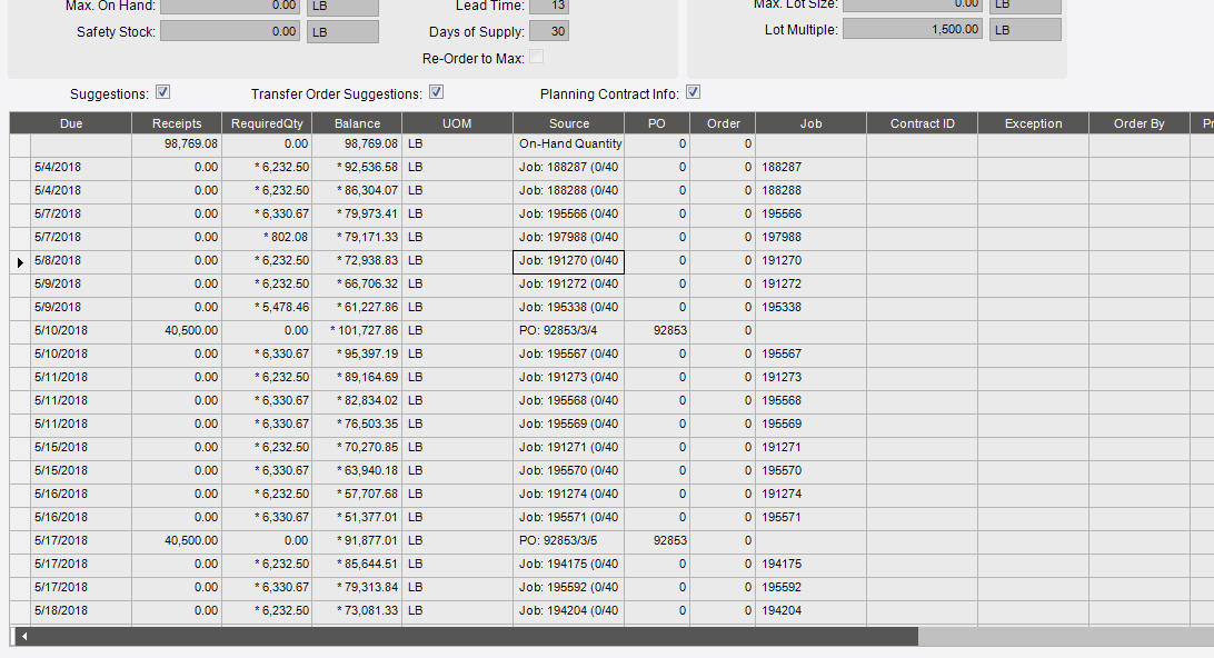

Time Phase Inquiry BAQ
Does Epicor have a canned BAQ for the Time Phase Inquiry?
Or does anyone have a BAQ that replicates it? I want to use my resources before I spend time building up a BAQ.
I am trying to make a custom report and the Time Phase Inquiry is my starting point.
Thanks!

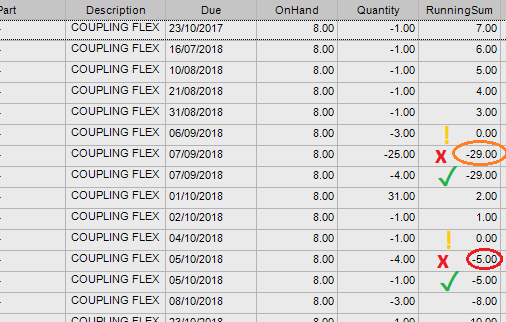

Hi @Gnewsom, I think this is a brilliant code. However, it doesn’t work well when the RunningSum value = 0, then the RunningSum value on the next line is not accurate.
I realized this post is from 5 yrs ago but I hope you have a solution for this issue?

RunningSum=Sum(Quantity) over (partition by PartDtl.PartNum order by PartDtl.DueDate ROWS BETWEEN UNBOUNDED PRECEDING AND CURRENT ROW)+isnull(OnHand,0)
Thanks a lot for your help !
Hi Himal,
Glad you found a solution. The way I wrote it, all the supply and demand on the same date gets lumped together due to the way ORDER BY works. Another possible way to fix it would be to include more variables in ORDER BY to break the ties i.e. job number and PO number.

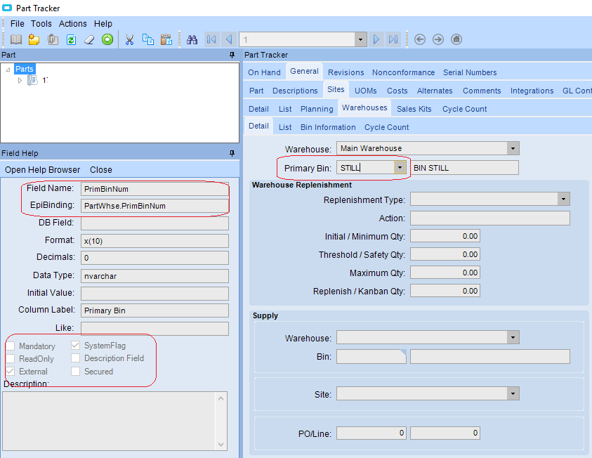

Also, I wanted to add a filter where the BAQ results only show the primary bin number. but since this is an external field, I couldnt find it under the PartWhse table in the BAQ. Would you know how this can be done? @Hogardy
Primary bin can be found with PlantWhse which show for each plant, the Primary warehouse, then via PlantWhse you get the primary bin…

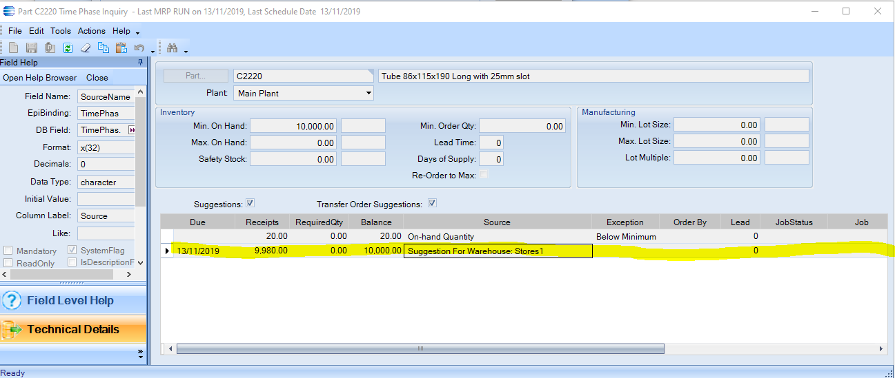

Hi Sorry to add on but it relevant to this topic.
Does anybody know where the table is for source suggestions as highlighted in the image.
I was just working on a project and needed to find this as well. TimePhas is empty
PartDtl.SourceFile
"Indicates the record type that created this record.
JH-JobHead, JA-JobAsmbl, JM-JobMtl, JO-JobOper, PO-PoRels, OR-OrderRels, FC-ForCast "
Hopefully that helps a bit. I imagine there is some other calcs that go on to translate.
