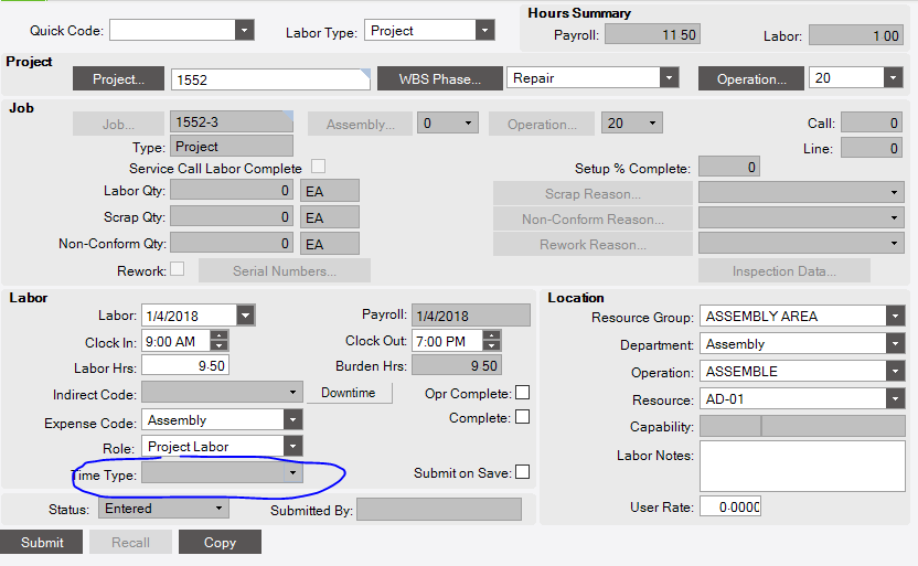

Hi, I want to calculate job labor cost based on Labor Role Code and Time Type. I set up some role codes and time types in system.
When I created a new time detail, after select role code, the time type field was still unavailable.
How can I active time type option? Thanks.
Do you have the Project Billing module licensed?
Yes, I am able to select time type now, but the labor rate still pull from Employee regardless which time type he worked on.
If you have Project Billing the next thing to check is if the Project is a FF or TM Project. If it is FF then no time types will be available… If I recall correctly.
