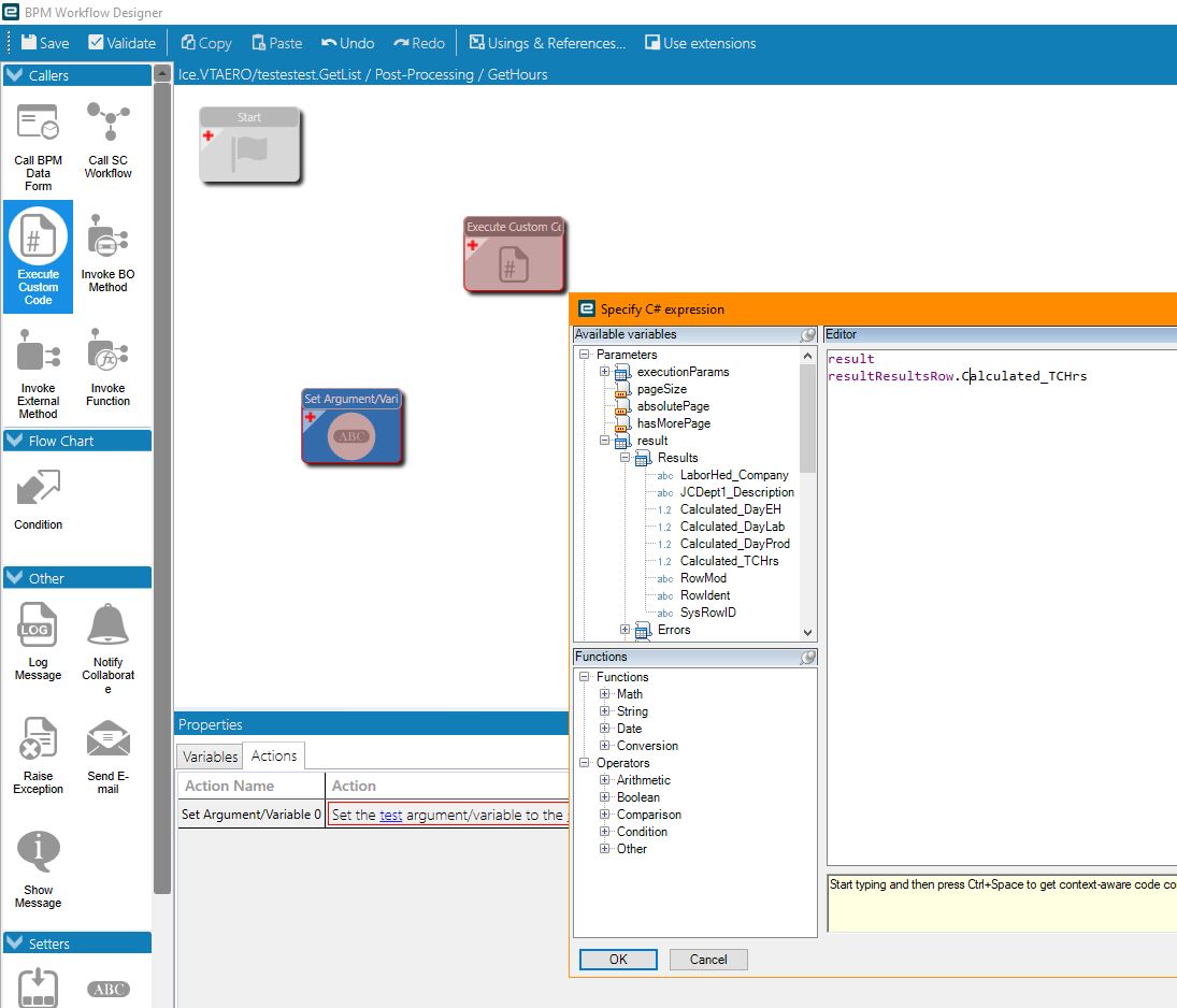

For example, once I have a function published, what is the easiest way to test it? I have to pass in an EmpID and a Date value to my function. If it works, it should show a messagebox with the hours information for the date I entered. I should be able to make labor edits if I can get the messagebox showing the correct values.
I am testing my published function as shown below. I am testing it using a UBAQ BPM that just fires the function. When I pass in known values for empid and date, I get an error: Unexpected character encountered while parsing value: <. Path ‘’, line 0, position 0.
I think this might be due to the way the date is passed in. My API wants YYYY-MM-DD, and epicor has a DateTime variable. Am I on the right track her?

Thank you so much @klincecum! With some syntax issues out of the way, I think I have a working function!
This function takes the Employee ID and Date as inputs, and outputs the hours from the timeclock for that employee and date.
To sum up the steps:
  1. Create an API in Epicor so that you can test the function in Swagger (REST API Help in my bookmarks). This is only necessary for testing and can be disabled later. You also need to set the access scope when you create this API key. I called my API Key AsureAPI, and I called the Access Scope AsureAPIAS. I know, I am great at naming. The Access Scope has all the libraries (functions) I am creating for this Asure integration. I am not sure if I need them all in there, but just to play it safe I added all four of the functions that were suggested earlier in this post. In retrospect, I will probably do all of it in one function, so I will adjust this scope later on. The Scope also contains access to the BAQ that I am using to test the function outside of swagger. As you add more functions to your library, or make new libraries, comes back to this access scope to add them.
  2. Create a new Library for a Function. Go to Functions Maintenance, add a new library. Check off Custom Code Widgets and Custom Code Functions. In this case I am not reading or writing to Epicor, so I left DB access = none. Add you references. I added the assemblies: Newtonsoft.Json, RestSharp.Json, RestSharp.Serializers.Newtonsoft.Json, and System.Text.Json. I don’t know which of these I actually need, but it is working with these in place. I did not add any table, service, or library references. In Security I added our company to the authorized company list.
  3. Add a new function. Mine was a widget function with code. Add in the input and output parameters for the function. In my case, I am inputting empid and date. I am outputting the hours from the timeclock for that date, and an extra variable for debugging. Now go design your function!
  4. Create the function in a custom code block. This code was partially created from Postman Code snippets, and Test code*.
*The test code generated in Postman was in javascript. In postman, I was able to use a “Test” to parse out the hours. I used very similar code in my final working version. Chat GPT converted from javascript to C#, and @klincecum helped clean up some dumb syntax issues.
  1. continued… Depending on the API there could be different forms of authorization. Apparently, there is a more secure way than the Basic Auth I used. I will get there by the end of this thread. I entered the Asure API user and password in Postman, that is how I got the basic auth value that I redacted in the code below. Don’t confuse the epicor API you use for testing the function, with the third-party API that you are calling from Epicor. This is what I ended up with:

  1. continued… After this custom code block, I added a show message widget that displays the input and output parameters. In the code you can see the commented out “output”’ variables that I had used while debugging. These were output parameters, but once I got it working, I removed them.
  2. Save and deploy the function. Actions > Promote Library to Production. Create a UBAQ to test the function. I set the UBAQ to just pull the top record from LaborDtl, then perform a custom action that just triggers the function widget. With Advanced BPM Updates, use the BPM Directives Configuration to create a new Custom Action. In the base processing, pass in values you want for emp ID and date into the function widget. Testing the BAQ should show you the messagebox from the function. Or it will show an error. In my case it was almost always related to the format of the date. Testing in a BAQ is not ideal, so try out Swagger. It comes with Epicor. My link is: https://redacted.epicorsaas.com/redacted/apps/resthelp/#/home
  3. Setup swagger to test your function. Open Rest Help API in your browser for the environment that you are working on. Pilot, in my case. Open the Epicor Functions form and look for the library that you created that contains the function. If you forgot to deploy your function, you won’t see it here!
  4. Click “Post”, then “Try it Out” to see the API Key and input parameters. Copy and paste your API key from Epicor. Type in the input parameters into the quotes. Click “Execute” and review the response below. In my case, a successful response is just showing the hours from the timeclock for the user and date.
  5. Inevitably this won’t work the first time. Repeat testing with swagger until it works. My process was to deploy the function, go to swagger and click “Execute”. Review the response, then go back to demote the function and design it again. Adding in extra output parameters helped me narrow down the issues. In the end it was due to the format of the input date. In my case, I can use the BAQ to test my function and I am passing the date parameter as: BpmFunc.Date(“2024/03/12”)

I see where you are going with this. I think I can make this work with some syntax help.
Normally, I would get at the BAQ results from the RunCustomAction, where I would use:
var ttResults_xRow = (from ttResults_Row in queryResultDataset.Results select ttResults_Row).FirstOrDefault();
However, the queryResultDataset ‘does not exist in the current context.’ So, I took a look at the results inside an expression editor. I see this:
I tried replacing queryResultsDataset.Results with just result, and with resultResultsRow. I think I just have the syntax off for this part of the call. Can you see what I have wrong?
