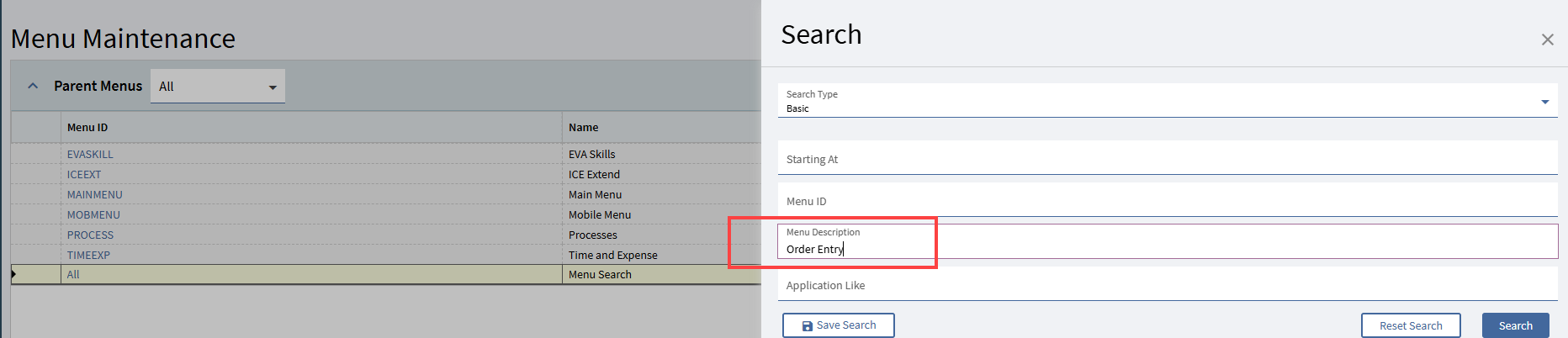

When you open menu management select “ALL”
Then search for the menu(s) that need to be updated.

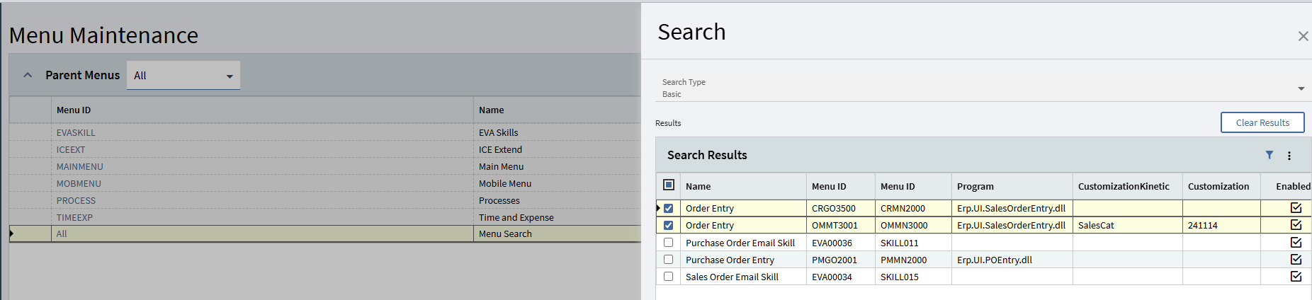

Select what you want to update - note one has a customization the other doesn’t.
You processes are now ready to be updated.
After you update one - use the crumb bar.
This will allow you to update both the Classic and Kinetic customizations easily.
