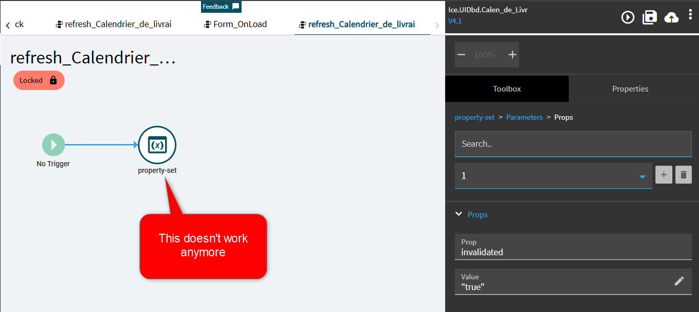

Having this issue with a customer this morning. The pattern here seems to be with dashboards that were built with the classic dashboard builder, having grid setup with “group by” then deployed as an application.
The issue is the refresh event invokes a “property-set” widget, which set the invalidated property of the grid to “true”. This event is triggered but does nothing. I had to create a new event to override the original refresh to call the BAQ widget.

All of our configurators (migrated from classic and uplifted) are broken too… I thought it was just us :dumpster_fire:
We did not even try to open a ticket. Experience told us that the end result will probably be “rebuild your dashboard from scratch without using classic dashboard deploy tool, have a nice day”.
No time to waste, we’ll fix it ourselves

Can you do a BAQ on Ice.XXXDef and find the layers then do a LIKE %property-set% on the column that contains the MetaFX JSON?

After fixing that dashboard for one user, another user has the same issue, and my fix isn’t working for his version. We are all looking at the same menuid. Some of us get the popout for the baq criteria, but this user doesn’t get the popout. I redeployed the menu item as a new menu item and it works fine from my side, but still no popout on his side. Is there somethign that could prevent the popout on a single client?
cache? Did you try an in private browswer?
Yeah I would:
  • Delete any personalization they have for the screen.
  • Shift reload if using browser - if using client clear cache and restart.
Turns out, I have to make at least some tiny change in order for the publish to actually fix anything
