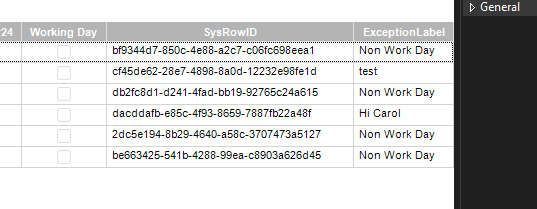

So the slide out that appears with the default value of “Non Work Day” is enough for the system to register this day as ProdCal.WorkDay = false?
It seems to be regardless of any value that is entered if exception label is created then mark as false, but wanted to confirm.
Yes, all that is doing is marking that day as a non-work day. You can enter a specific description or just accept the default.
