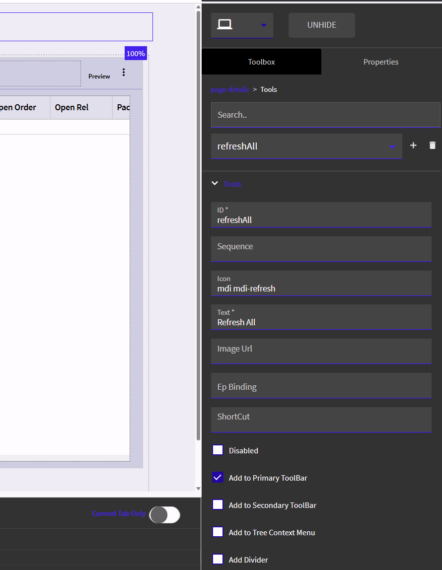

The entry “refreshAll” was already there. I enabled Add to Primary Toolbar (also tried the Secondary Toolbar), tried setting Sequence to a value of 1; but nothing seems to work to show it on the toolbar when I Preview the app.

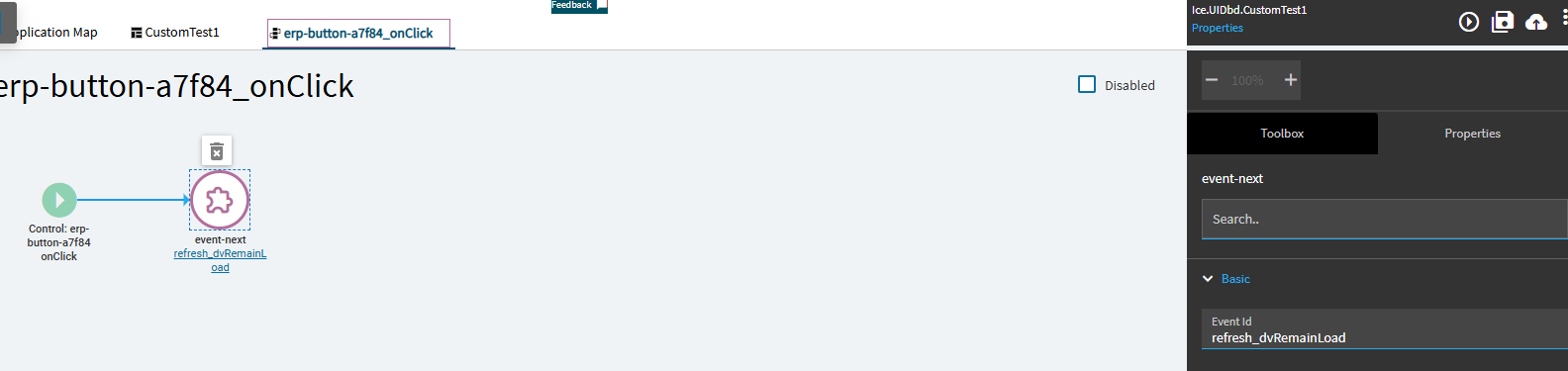

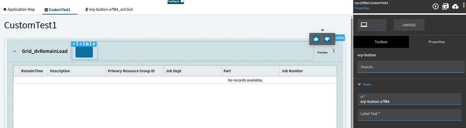

I added a plain old button to the header area in the panel. Then setup the button this way:
In the button on-click event, just trigger the dvrefresh that is added by the wizard:
If you don’t have label test in your button, then you just get the icon. Otherwise you get both icon and text.

If you go back to the page-details properties, do you have a Max Items In Toolbar set? it’s the very bottom of the Advanced section.
Max Items in Toolbar is set to 6.
Tried changing it to 3, then to 9. Still no toolbar icons.
You could also try adding it from the page-details on the Application Map screen in app studio. Should be the same but we all know app studio has its quirks.

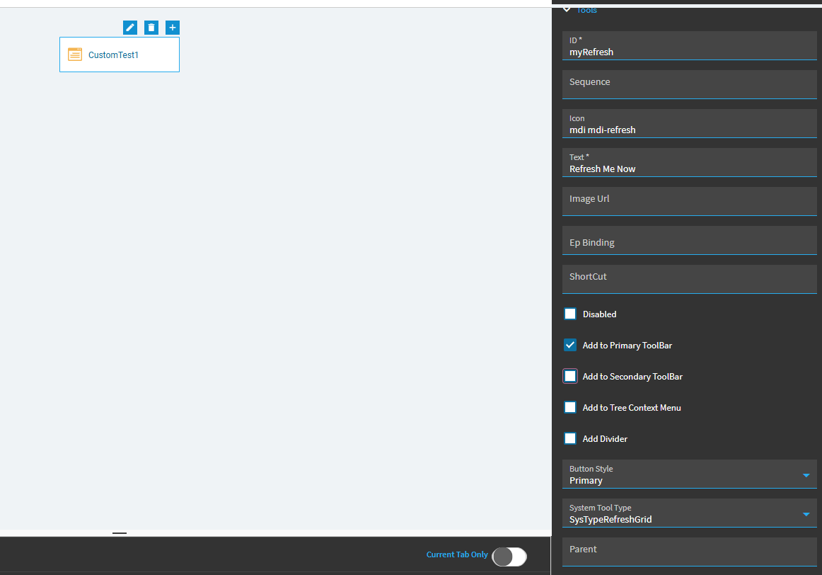

What if you name it something else? Add another button there and call it something else
There might be something keeping that refreshAll button hidden/disabled…
Oh Yeah! That seems to work too. This is how I changed the existing refreshAll entry in the page-detail > Tools:
EDIT: Actually I just added a new “Tool”, I didn’t edit the existing refresh All.
Edit, maybe it was just clicking the Add to Primary ToolBar flag… Who knows, flipping Kinetic…
