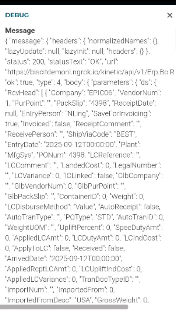

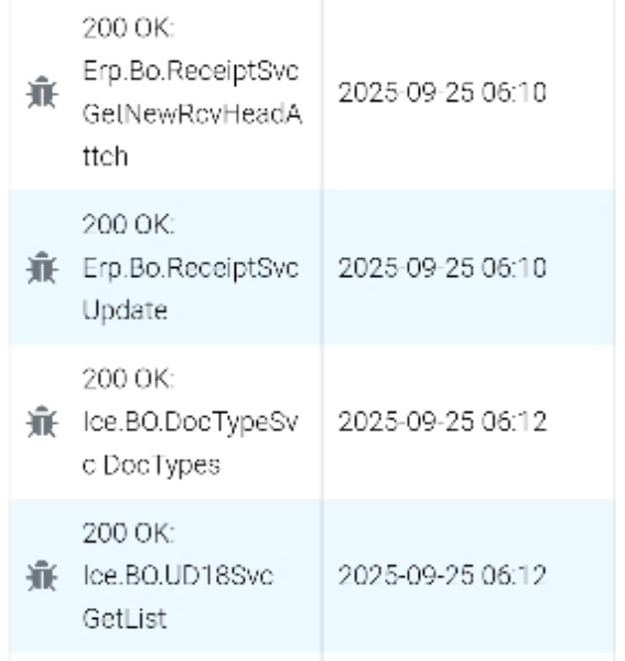

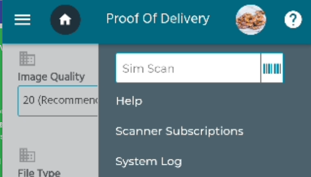

From the handheld you can see the API calls.
Question Mark > System Log (Clear all then perform your test) > Show Debug Logs > Select the Record

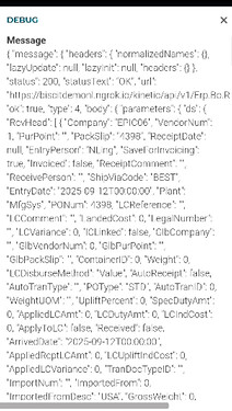

Full Log
Individual Record

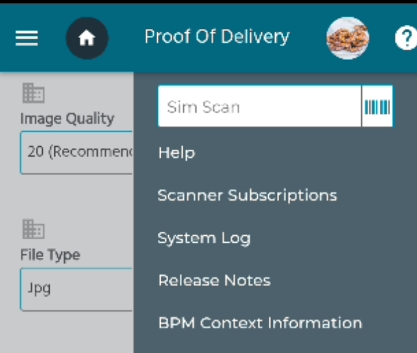

Also, if you decide to write a BPM, check out the BPM Context Information.
