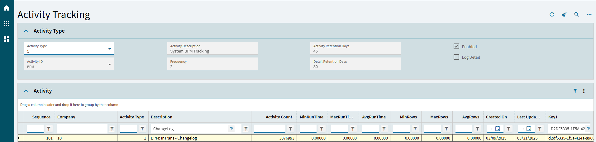

Looking at the new Activity Tracking dashboard, I now clearly see that this JobHead changelog is being called millions of times a month. Obviously, these millions of calls do happen, but they are being filtered by the condition to exclude Unfirm Jobs.

I am looking for a solution that would not affect the ActivityCount of the Data Directive. Any condition at the beginning of the DD will still count.
