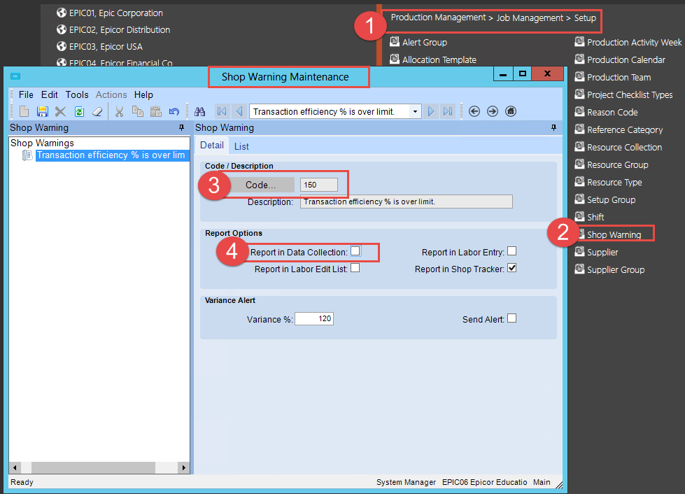

This is a shop warning that has been setup in your system. To remove it go into Production Management - Job Management - Setup - Shop Warning and look for the Code 150. Make sure the Report in Data Collection is not selected.
After this is setup as stated above the prompt will not be displayed anymore in MES.
