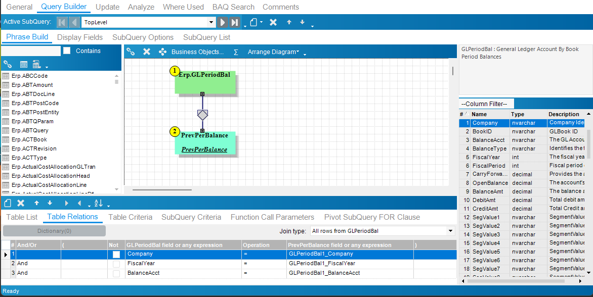

Hi there,
I am new to BAQs, so I need some help with this. I just want to build a GL Trial Balance BAQ that shows the opening balance of each period. The BAQ errors with “Bad SQL statement”.
When I remove the subquery criteria “having GLPeriodBal1.FiscalPeriod < GLPeriodBal.FiscalPeriod”, the BAQ does not error (but it won’t calculate the pervious period balance correctly).
I have also tried it without the “Having” flag, but it errors out the same.
The Analyze shows the error “The multi-part identifier “GLPeriodBal.FiscalPeriod” could not be bound”.
Any help is much appreciated!
Vassilis

Hi Sue,
thank you for the reply. I see one problem though. Your code does not pull the year opening balance of the account. It only calculates the sum of previous periods balances over the same year.
But how do you make the folding of the whole query around the starting “with”? My codes always start with “select”.
Anyways, I spent some time over the weekend and I found the following code works for me. I took a similar approach to your code. First explode fiscalper joining with every combination of glaccount. Then left outer joining with three separate subqueries for year-open-balances, previous-period-balances and finally current period balances. That’s why it is so long:
