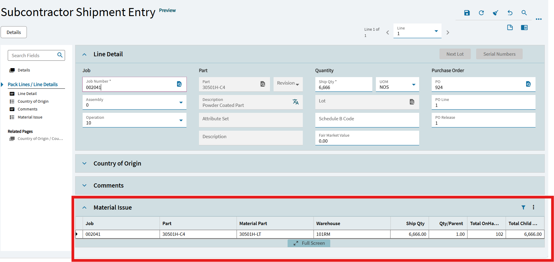

We have a client requirement where, in the Subcontractor Shipment Entry screen, the Job Number is entered in the line details. Based on this Job Number, we are able to successfully display all associated child parts in a UD (user-defined) grid.

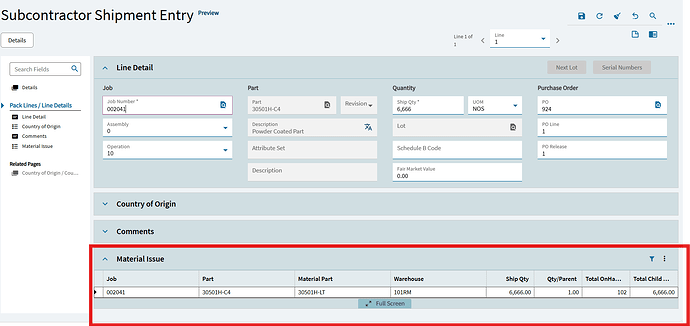

To support this, I’ve created a BAQ grid which populates all relevant child part data. As highlighted in the attached image, the grid marked in red is the one I developed, and it displays all the necessary information for the child parts.
