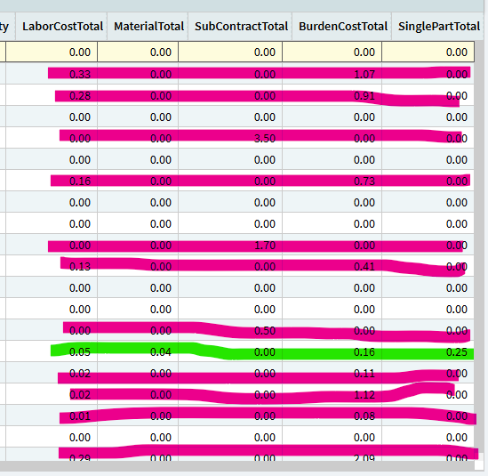

Ive got this BAQ that estimates the cost of a single scrapped part at any given operation. The BAQ works alright. I get a few columns to add up at the end.
It should be easy to add up the values for these 4 columns, to show a single total per row. But this is not working like I expect. Some rows dont get a total at all, and some do.
The formula for the field in question is a simple sum:
SubQuery1.Calculated_NewLaborCostTotal + SubQuery1.Calculated_MaterialTotal + SubQuery1.Calculated_SubContractTotal + SubQuery1.Calculated_BurdenCostTotal

In the example above the last column should be my total. You can see only one row where it calculates correctly. The others are missing data comepltely.
I even moved my total to a subquery to make sure that grouping wasn’t causing any problems. This seems like a bug to me. Anyone else found an issue like this? What can we do to fix it?
My best guess is you have some null values floating around.
5 + null + 7 = null
MaterialTotal seems like a good place to start. It is the only value in your above image where the green row is NOT 0 and the math worked. Every other row, the displayed MaterialTotal value was 0 and the math broke down. So, perhaps the grid is displaying 0, but the values are null.
But, you may want to hit each variable with an isnull() expression… so if the value is null, it results in 0 instead of a null value.
For example:
(iif(MyQty=0,0,isnull(JobMtl.TotalCost),0) / MyQty)) as [Calculated_MaterialCost]
Yep, nulls in a decimal field display as 0.00 for some reason, so it’s hard to tell. I usually just wrap everything in ISNULL( field, 0 ):
ISNULL(SubQuery1.Calculated_NewLaborCostTotal,0) +
ISNULL(SubQuery1.Calculated_MaterialTotal,0) +
ISNULL(SubQuery1.Calculated_SubContractTotal,0) +
ISNULL(SubQuery1.Calculated_BurdenCostTotal,0)
I reported this to Support and this was their response:
"This is a known issue that development already reported under KNTC-28275. Below is the description of KNTC-28275.
KNTC-28275 - If a field in BAQ designer contains NULL (for example, for left outer joins) grid still shows default values for it - that is Boolean field looks like False (unchecked checkbox), integer field shows 0, and decimal field shows 0.000.
This is incorrect and misleading for BAQ results, smart client showed empty cell in this case "
