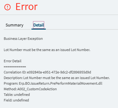

I’ve got some lot controlled material that was purchased directly to a job that I need to return to inventory and issue to another job. Everything I have read suggests that this should be possible, but when I try to commit the return it throws the following error:
I have triple checked that the lot number I am trying to return is what was issued to the job.
The pack that this material was received on is fully received and invoiced.
I see the line in the error “Method: A002_CustomCodeAction” and wonder if that’s a clue. Could this be caused by a custom BPM? We are using the “Aerospace & Defense” bolt on by Cre8tive Technology and Design.

Yeah that could definitely be it. If you have a test environment you could try to replicate this in that environment.
Good thinking. I’ve got a Pilot db where the receipt hasn’t been completed yet. I’ll see if I can replicate the problem and then start turning off BPMs off.
Well that was it…disabled the custom BPM and the transaction went through just fine.

You found the culprit though! Glad that you had a test environment up to date, not sure what the BPM was doing and if disabling it for a moment causes any issues with the logic surrounding the “Aerospace & Defense” bolt on, but if it works it works!
The BPM is protected, so I suspect that is preventing me from seeing what it does? Turning a BPM on and off is right about where my knowledge tops out lol
