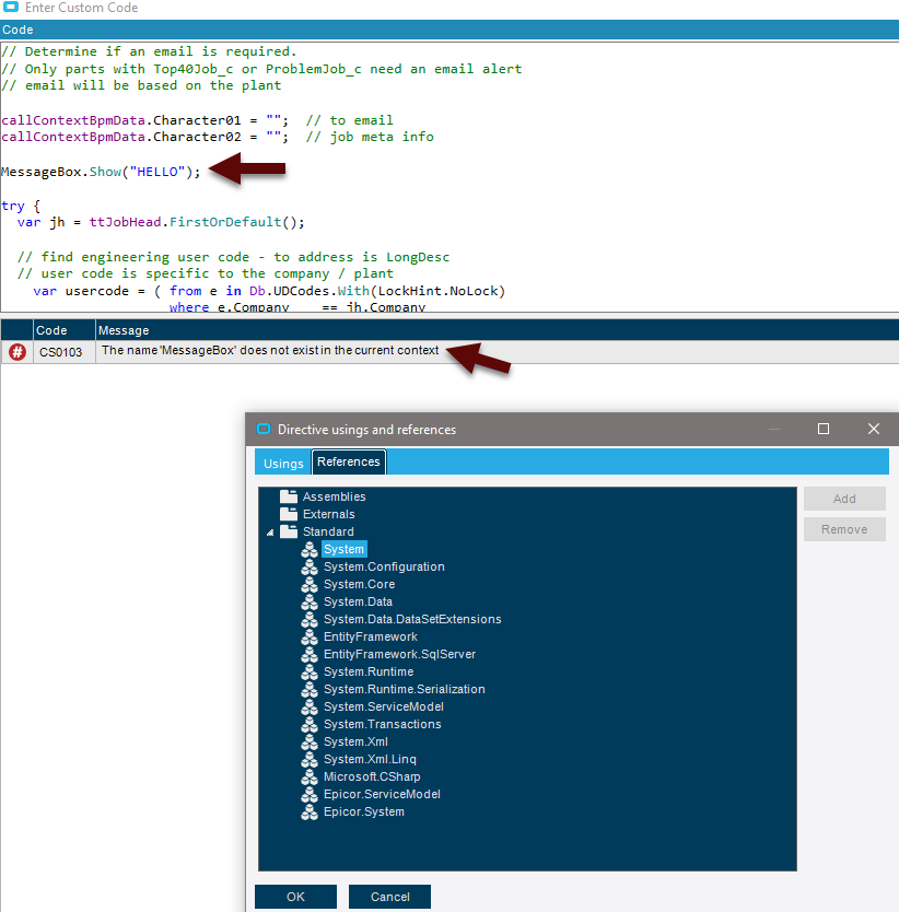

Correct. I’ve tried a bunch of different things that I’ve found on stack overflow and github but nothing seems to work or I don’t have the correct references or I’m not instantiating a message box. I don’t know what I need to be “Included” or how to include it.
I tried to add: MessageBox.Show("HELLO");
I get syntax error: The name ‘MessageBox’ does not exist in the current context. I get that error a lot. I’m unsure of how to add dependencies that I guess C# requires.
BPMs run at the server, so if the code did run, you wouldn’t see it at your client. That’s why BPMs have a message widget that passes that back to the client.
I would go with Chris’s suggestion and use logging.
That worked pretty good. I guess that is how you do it. Thank you.
I knew Epicor must have had their own way to do it. Regular C# tutorials don’t mention that at all. Are there any C# Epicor BPM video tutorials? I can usually figure out the C# syntax but just not the Epicor way.
