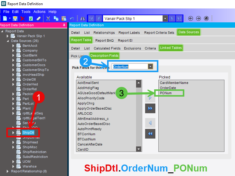

FYI - there are often several tables that can be “linked” to a given data source table in a Report Data Definition (RDD). You’ll see those by selecting the table in the RDD and then looking at the Linked Tables tab. This is where you can define other related columns to be pulled into the report (if they weren’t already there). They show up in the dataset with the table name of the data source and then the column name is the combination of the linked column and the column in the picked Links.
