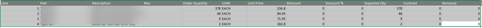

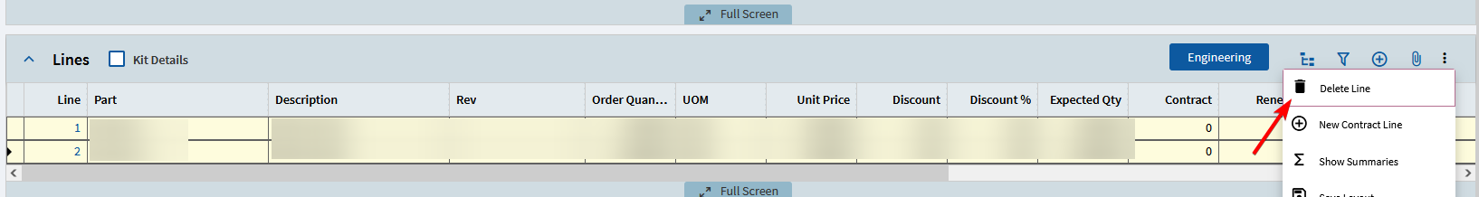

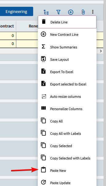

  1. Copy all lines:
  1. “Export selected to excel” (if you use copy selected, when you paste back into excel the data type may drop important information - we had leading 0s in our part numbers which vanish)
  1. Change the part numbers in all cells you want to change
  2. Delete the existing rows
  1. Highlight the rows you want to add back, and don’t include the column headers
  1. Paste new
That’s a key step
