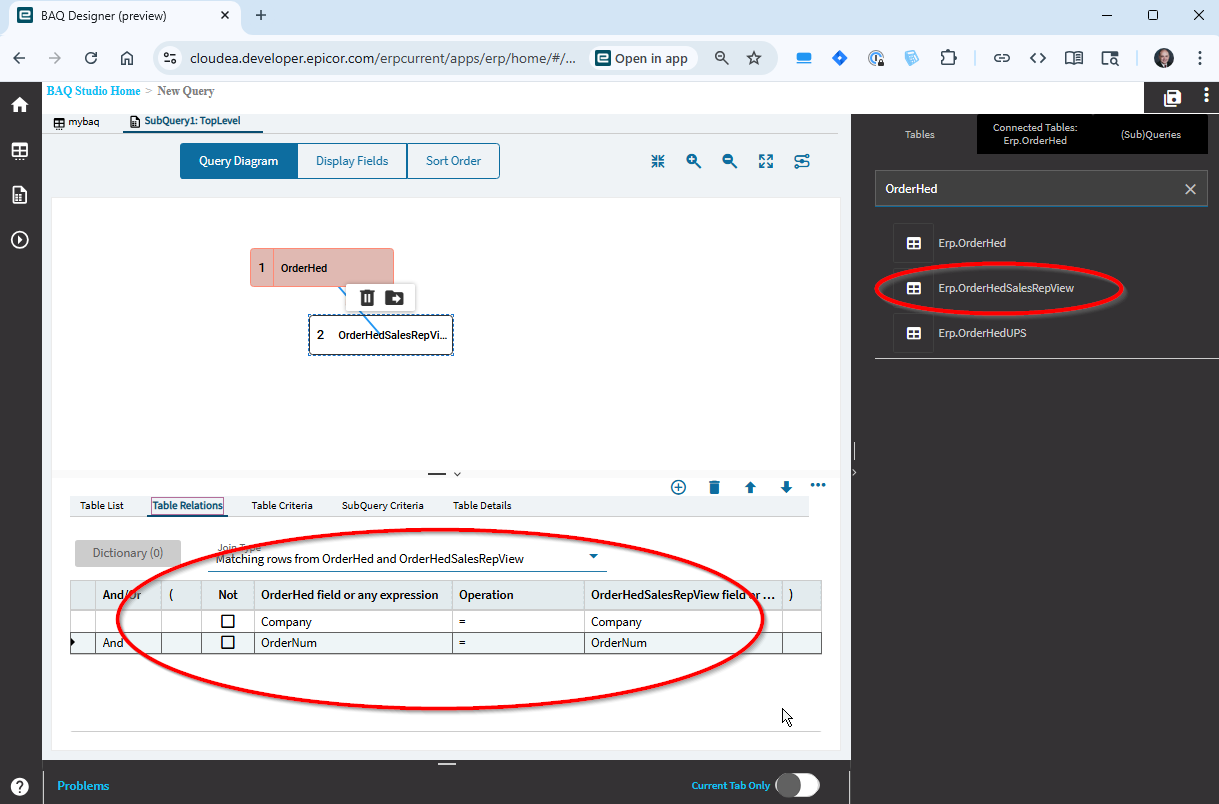

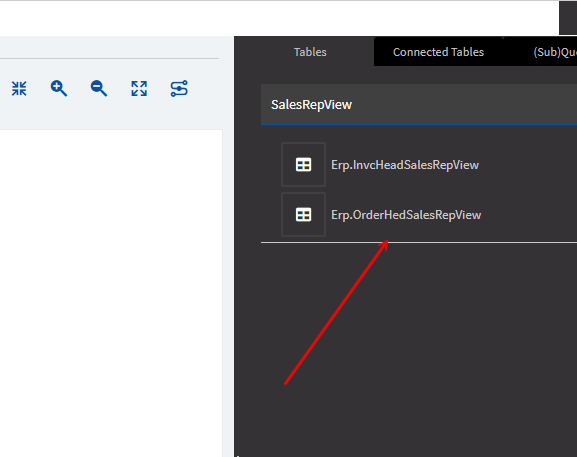

It shows up in BAQ is just a couple of new views
InvcHeadSalesRepView
OrderHedSalesRepView

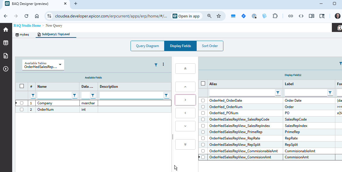

You create a BAQ that links the OrderHed to the OrderHedSalesRepView
then you can select the fields in teh salesrepview to be displayed… they are already split out for you. If there is one rep, then you will get one record. if there are 3, then you will get 3 entries. no need for complicated query anymore. it “looks” like a separate table with this view, even though it is still stored in the table the old way. We did this so that anyone who had already created BAQs/Reports to handle it the old way was still supported, but anyone new can do it easier.
