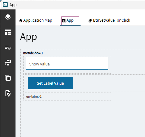

The test example I am trying to make work is to Take the value of a Textbox and change the value of a label after clicking a button.
I am not binding this to any dataview. I read about TransView but cannot seem to get this to work.
My Controls
Textbox : txtShowValue
Button : btnSetValue
Label: ep-label (I guess you cant set the id of Labels)

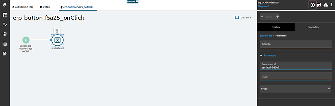

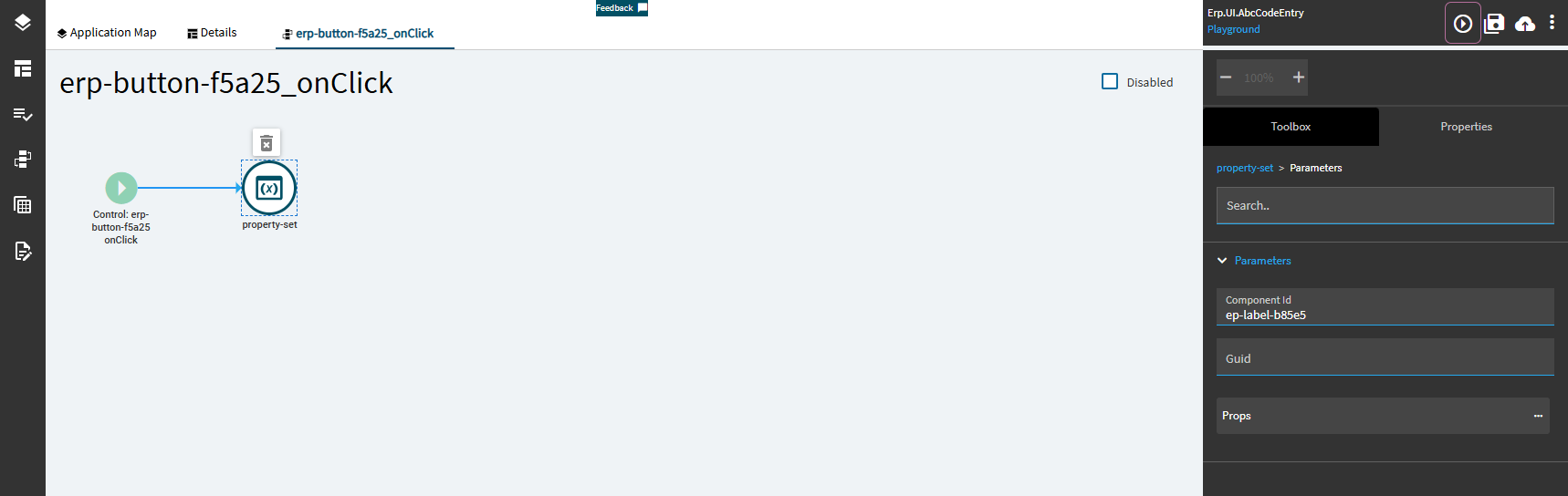

You’ll need to add a property-set widget in the button’s on click event. There you can change the labelText property to the new value.

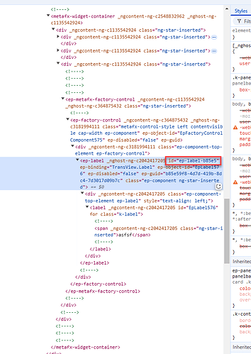

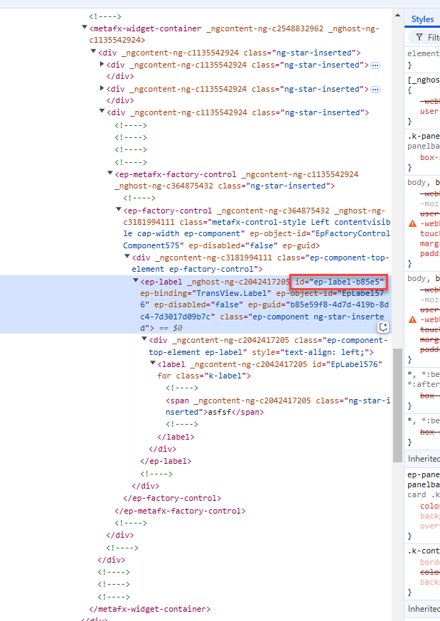

You can, but not easily.
Because they don’t expose the component ID, you have to add the label to the screen, preview it, then inspect the label element to get the ID from the HTML and then do as @jwphillips mentioned and use the property-set widget.
And make sure you get the right one or you get some fun behavior like this. :rofl: :rofl: :rofl:

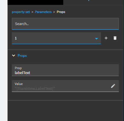

LabelText
Getting closer
My Textbox : txtShowValue is unbound

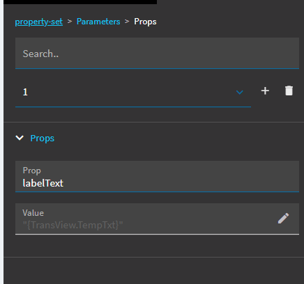

I found the label id: ep-label-b74da and set the Props to
When I input data in the txtShowValue and click the button I get
As in “not bound to TransView.TempTxt”?
If I understand correctly, the interpreter will try to find a field as written, but if it doesn’t find one, it spits out the expression as text. Check the value of your field in the debugger (Ctrl+Alt+v) to verify it exists.

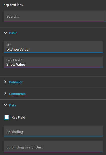

Let’s see the Properties > Data for the Show Value textbox.
If I put anything in the EpBinding box, I can’t type in the txtbox when I preview the form in browser

You have to. Based on the other, you need to put TransView.TempTxt in the EpBinding.

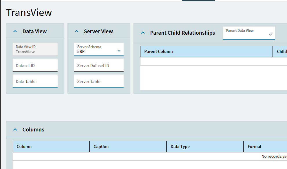

Is this a custom App? Most apps come with a TransView defined. If it’s custom, you will need to initialize the view yourself. To do this, create an event that runs after OnLoad and use a row-update to set TransView.TempTxt to "".
Custom App

Alright, so create a dataview called TransView.

Add a row-update widget in there where you set TransView.TempTxt to "".
Take the equals sign out of the expression field, otherwise good.
Take the string data type out too. Not needed.
