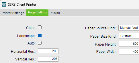

If I preview it and use foxit, it prints landscape fine.

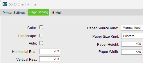

If I modify the Client Page setting from:
Landscape: (not checked)
Paper Height: 400
Paper Width: 550
To this:
Landscape: (checked)
Paper Height: 600
Paper Width: 400
It prints fine.

I just kept trying different things and something worked.
Not sure what.
May have been changing the report size.
Anyways, this seems to be working now.
