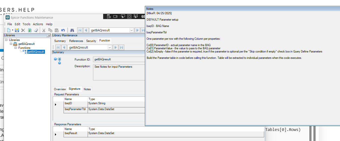

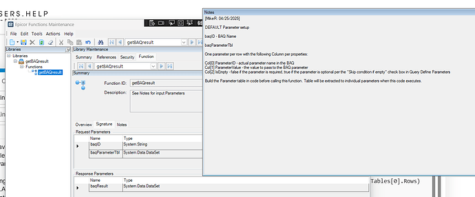

Here is how I set up the function in Function Maintenance.

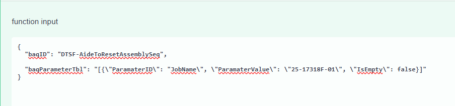

Here is the attempt I made to pass a table as a function input parameter after asking CoPilot.
I searched but did not find anyway to format this parameter table as a CSV.
Anyone have any thoughts?
Don’t know if it’s your whole problem, but you misspelled parameter in your payload.

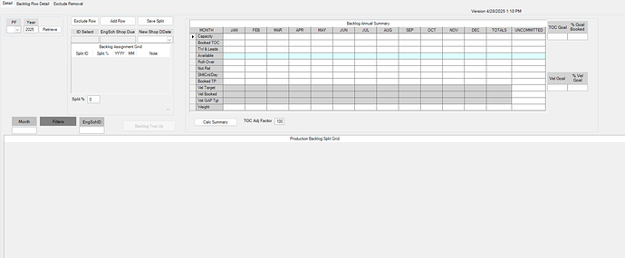

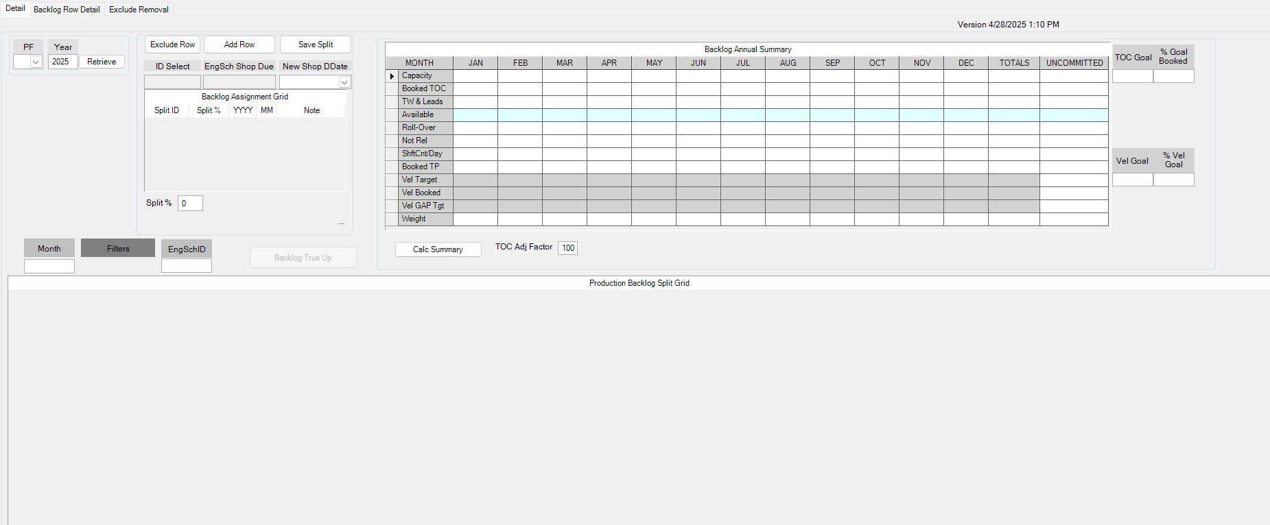

For an example Currently I have a customization that loads a detail grid on the bottom and then summarizes each cell in the Summary Grid at the top by Month, our Backlog. If I tried to do this in Kinetic Application Studio I would have to load the Detail Grid then pass it to the Summary Function to generate the Monthly Data. Note that the grid below is not populated for this image, sensitive data.
Each one of the Cells in the summary grid is a method that calculates against the Detail Grid One month at a time.
