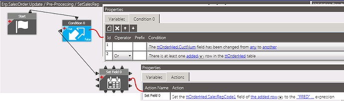

Have you tried something like the example below
This is what I have on a Test system, where I had been fiddling with setting the SalesRep a few weeks ago - hard coded a repcode.
But let me know if it doesn’t work and I can try and check the production system later where I know the final version was working - looking up a rep from customer instead of territory/hard coding. Also I know I added one for quotes at the same time, set rep when converting to an order ( if I remember, on that one I had to use a data directive).

My BPM was not setup like that - but I can see why that might work where mine failed. I was trying post-processing and In-transaction directives. And I wasn’t always seeing the SalesRepCode1 available in the widget. I also didn’t consider the Update method because I thought - I don’t want to run this every time someone updates an order. So I was trying to find the right GetOrderHed or similar Method.
But from my reading, it seems like those fields are not actually stored in the table but are created from the SalesRepList field. Might make sense why Post-Processing wasn’t working like I thought.
