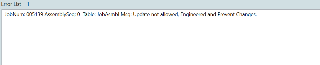

error i am getting on exisiting jobs
That means you have the Engineered checkbox still enabled on the Job header. That checkbox must be cleared to make changes to open jobs.
There is a setting in Company Configuration that allows you to override this, but I wouldn’t recommend changing that setting without discussion with your Engineering department.
