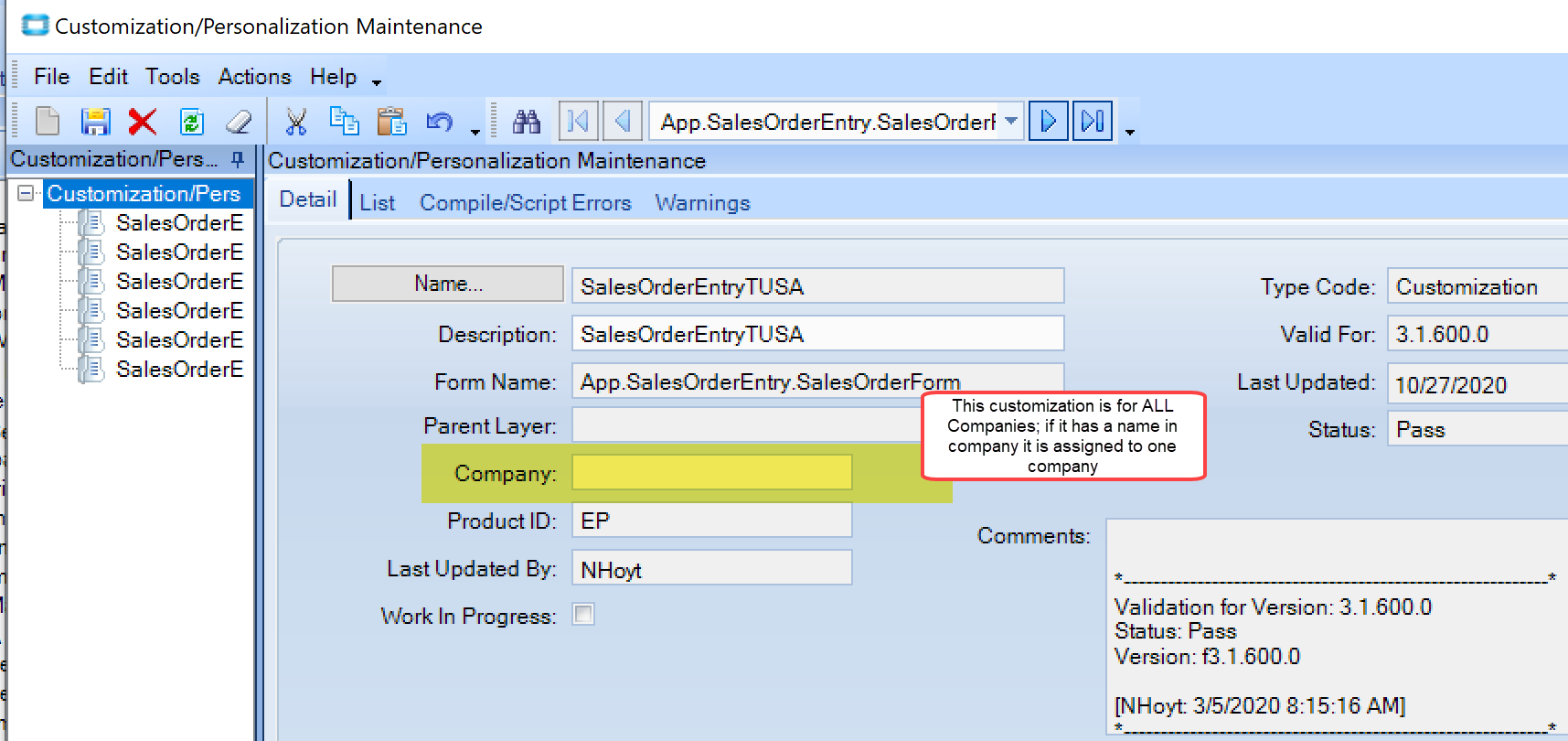

We have had this happen when one customization has been saved with a company assignment and another customization (same name) for “All Companies”. (we are not multi-company). See first screenshot associated field.
I would review what you have in Menu maintenance for whether you have All companies checked or not per second screenshot and if one way vs other, compare to the customizations and ditch the one that doesn’t agree with your menu maintnance assignment. This is assuming that the customizations are actually the same… (i.e., otherwise I’d review the code/customization done to each and ditch the older one).

You can also have customizations with same name BUT for different “Form Name”. See my screenshot customization maintenance above… I have customizations called Sales Order Entry TUSA on both Form Name = SalesOrderForm and Form Name = CopyOrderForm. This was done to get the customization to load properly automatically, but that’s another story. Do you have multiple SAME NAME customizations for SAME Company and SAME Form Name?
Maybe show a screenshot of your concerning customizations pulled up in customization maintenance?
Nancy
