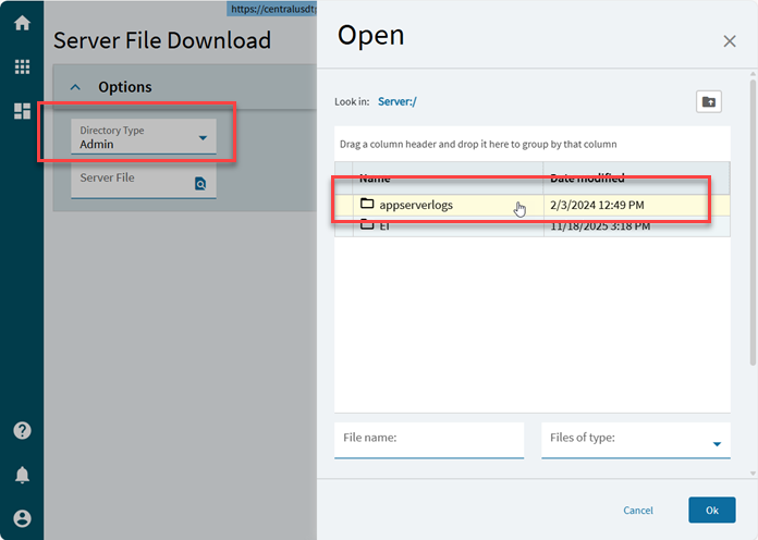

I am on cloud. I went to Server File Download, but I don’t see any files that relate to the issue. I couldn’t find any files there that had a recent date, so I think I dont have access to that.
You checked the admin folder I assume.
You’ll want to go into the Admin \ Log folder, pull the latest log file (or the right one within range) and search for the string.
My Dev Tools dashboard has a log file search that you can plonk the correlation ID in, and it will take you straight to it. (on cloud)
We’re on cloud - select Admin from the dropdown, then look for the appserverlogs folder. Can take a few seconds for the folder to appear but then you should be able to search/download the appropriate file.
EDIT - or use @GabeFranco 's dash, probably a lot easier lol
They should be in as @GabeFranco said under Admin appserverlogs folder. I agree Gabe’s tool is easier than the method Epicor forces on us.
