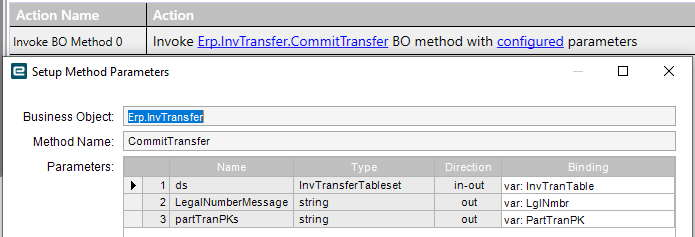

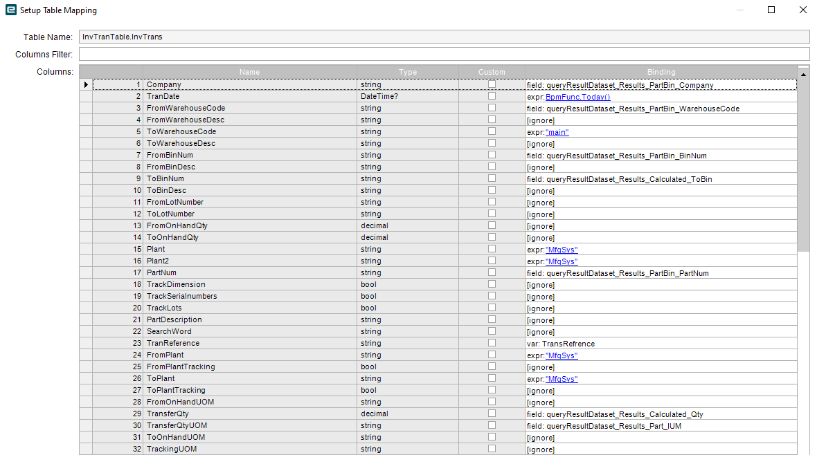

For just the Inventory Transfer you need to make a BAQ and grab the Values required to populate the InvTranTrans Table like so.
Var TransRefrence is just a string that you want the Transaction reference to say, this is optional iirc.
Also update RowMod with ā€œUā€ at the bottom of the Table.
Then feed that into a BO Method Erp.InvTransfer.CommitTransfer
If you need help with the Moving WIP products as well its a little more involved, but i can help.
