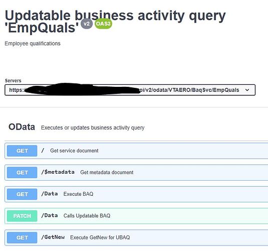

The REST helper shows to use PATCH not POST:
I cant seem to get either to work.
Then something is wrong with your request.
Set it up manually in postman until you get it working, then compare very carefully what you are sending. Something is wonky.
I can’t get any POST or PATCH to work in Postman. Has anyone had luck with UBAQ updates via the API?
EDIT: I keep getting 405 Method not allowed on POST and PATCH.
The PATCH in my REST helper, shows a differnt color than the other methods, and when I open it, it shows it calls the updatable BAQ “testUbaq”. All the other methods reference my UBAQ EmpQuals. I am guessing PATCH/POST is not supported yet?
I got it in postman! I was missing the /Data in my URL.. Uggh..
This is my PATCH URL:
//MYSERVER/api/v2/odata/VTAERO/BaqSvc/EmpQuals/Data
And I sent the whole kit of data that PATCH showed in REST helper. I made a couple of edits, like changing rowmod to U, and editing the Number01 value.

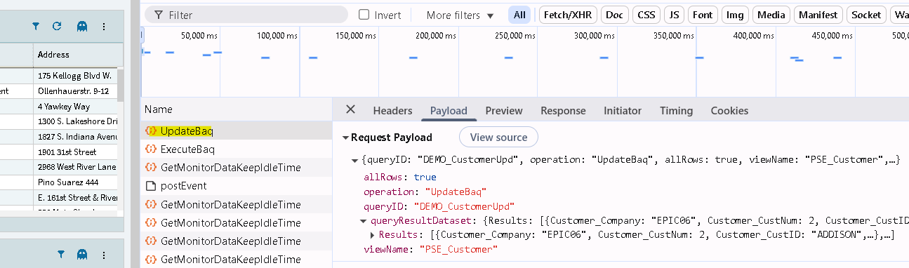

I went to check in a Dbd Kinetic App with an updatable grid/baq and behind the scenes it calls this service and method instead: Ice.BO.KineticErpSvc
There is also this other service. I haven’t tried calling an update from this one.
