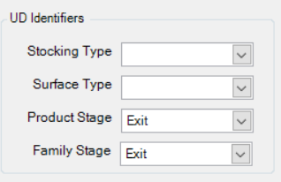

Hello,
I have added 4 UD Fields to the PartPlant table PartPlant_UD. These are not ‘Shortchar01’, I created these through ‘User Codes’.
These UD Fields are visible on Part Maintenance->Site->Detail
This is great, I figured out how to show the CodeDesc instead of the CodeID in the field so users can select the CodeDesc instead of the CodeID from the dropdown.

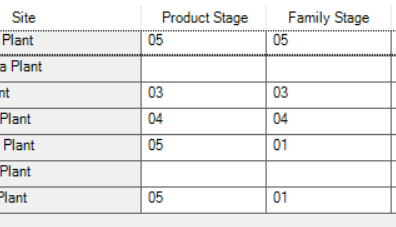

When I look at it in the ‘List’ view of all our Plants it uses the CodeID. How do i change the list views to display the CodeDesc?

You need to get a hold of the grid, and using a bit of code, replace the column with the combo box.

private void SetupNMFCCombo()
try
string displayField = "Product";
string valueField = "NMFCCode";
List<string> sdl = new List<string>(){ valueField + "~" + displayField };
sdl.AddRange(nmfcCodes.Select(x => x[valueField] + "~" + x[displayField]).ToList());
cboNMFCCode = new EpiCombo()
RetrieveOnActivate = false,
EpiStaticDataList = sdl.ToArray(),
EpiColumns = sdl.FirstOrDefault().Split('~'),
ValueMember = valueField,
DisplayMember = displayField
cboNMFCCode.Font = new Font(cboNMFCCode.Font.Name, 16);
cboNMFCCode.Width = 800;
string phantomGridGuid = "7c8d2d07-d24a-4a4f-b0c2-613e684895d4";
EpiUltraGrid phantomGrid = (EpiUltraGrid)csm.GetNativeControlReference(phantomGridGuid);
phantomGrid.DisplayLayout.Bands[0].Columns[fieldAlias_NMFC].ValueList = cboNMFCCode;
phantomGrid.DisplayLayout.Bands[0].Columns[fieldAlias_NMFC].Style = Infragistics.Win.UltraWinGrid.ColumnStyle.DropDownList;
catch (Exception exOuter)
LogSystemException(this.GetType().FullName + "." + System.Reflection.MethodBase.GetCurrentMethod().Name, "Outer", exOuter);

Simply get a hold of the Guid for the Grid then assign your Combo to .ValueList in the _Load event
Example:
EpiUltraGrid grdReleaseList = ((EpiUltraGrid)csm.GetNativeControlReference("ade15bd6-f013-4543-a43d-871071e76021"));
grdReleaseList.DisplayLayout.Bands[0].Columns["smVI_Misc1_CodeID_c"].ValueList = cmbMyComboName;

Pretty much it If you have a combo use it, if not use Kevins snippet above to create one.
